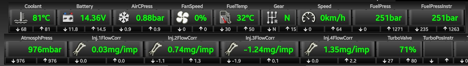

Hi! I turn to you with a problem that given a 2009 1.6HDI 9HZ engine code C5 with a 1st injector correction value fixed at 0.03mg and unchanged. Has anyone encountered a similar phenomenon? Could someone give me advice on where to go? The car is going nicely. It doesn't smoke. does not consume much. I unplugged the particular injector and it was uneven. when i put it back the idle smoothed out. So the injector works. just for some reason the ecu thinks it should keep it at a fixed value. Thanks in advance for the answers. (sorry for the english I'm writing with a google translator)
