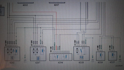

Firstly, getting the wiring to work. Below are attached wiring diagrams from dispatch and expert tepee.
Dispatch 6218 plug is:
pin 1: G/Y wire ground,
pin 2: red wire always hot, even when locked,
pin 3: hot when door closed, even when locked,
pin 5: signal to lock door, hot with key fob press,
pin 4 : return to ground
pin 6: Brown wire
Dispatch rear door wiring:
Expert lock 6222:
pin 1: pulse power to unlock motor - Currently just pulse 12v from powerpack to unlock from inside
pin 2: ground
pin 3: connected when door shut
Tailgate opening latch 6282:
switch connecting pin 1 to pin 2 which is currently ground:
Expert Tepee wiring:
I can get door ajar sensor to work by connecting pin 3 of 6222 to pin 3 of dispatch 6218 and pin 2 of 6222 to pin 1 of 6218.
I'm not sure on best way of getting tailgate button to open door only when van is unlocked. If I use pin 3 or pin 2 with switch in-line then the door will never get locked. Also, doesn't seem to unlock door if pin 1 6222 connected to pin 2 of 6218. Below is the best idea I have had so far, which would require both switch to be connected and key fob pressed to unlock tailgate.
Potential wiring:
Has anyone done this before? If so, how have they done the wiring? Has anyone managed to make the tailgate open with button only when unlocked. Ideally without running more wires from BSI.

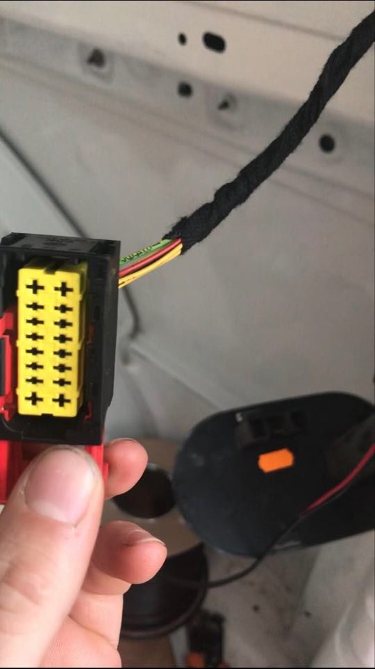

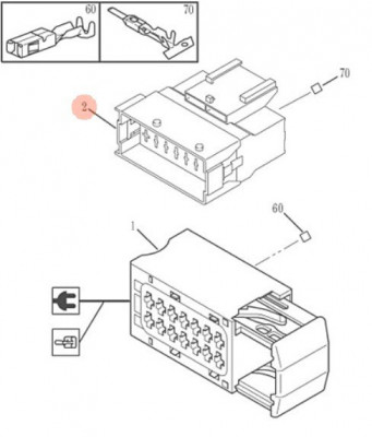

Does anyone know where I could get a connector to match the current plug, pictured below?

On models with a tailgate the rear door does not physically lock when you lock the car, it just ignores the input from the tailgate microswitch.
Are the loom connectors not standardised? I would have expected there to be a plug in connector then a but of re programming to get this to work, can see PSA making t different harnesess.
Are you looking for the same plug in the pic or the matching male one?

So the plug was cut off the tailgate loom, so having to wire it up manually and so would like the opposite of the plug pictured.

The matching plug is part no 6541P8 £6.07 + v
You need the terminals separate, There are 2 sizes of terminals as the outer ones are bigger part nos 6541G4 (small) & 6541G3 (big) they are around 50p each.
*I know the pic shows only 14 ways in the plug but its just an example to show the type of plug, the part no is for the 16 way black version*
