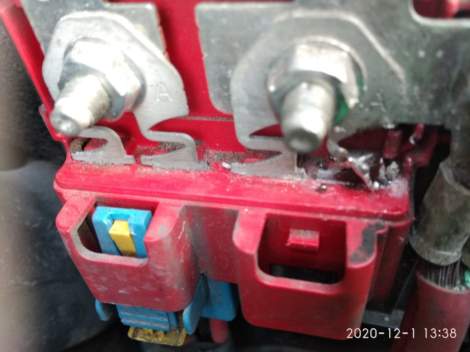

FIXED- UPDATE ******
checked all fuse boxes for blown fuse and all relays for loose connection/corrosion, etc
Considering the car was parked for two days, working fine before i parked it up, I could nnt see a water ingress issue being the concern.

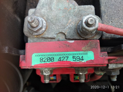

Turns out it was a corroded FUSE LINK (one of 4) that are fixed to the +positive battery terminal in a red plastic housing.
Made a temp solder joint across the corroded bit and PRESTO !!! no more "Braking fault" and it turns over AND IT STARTS !!!
Just ordered a replacement Battery Terminal Fuse Link part ...

These 4 battery terminal fuse links supply power to the cars main fuse boxes/bcm etc.. not surprised the vehicle was throwing up errors ( I suspect the blown link supplied the abs unit or a brake related element).
I did notice the bulbs in the headlamps did not work (although cluster lit up when I turned headlight switch , when I had the braking fault message ).
Battery terminal fuse
Blown battery terminal fuse
