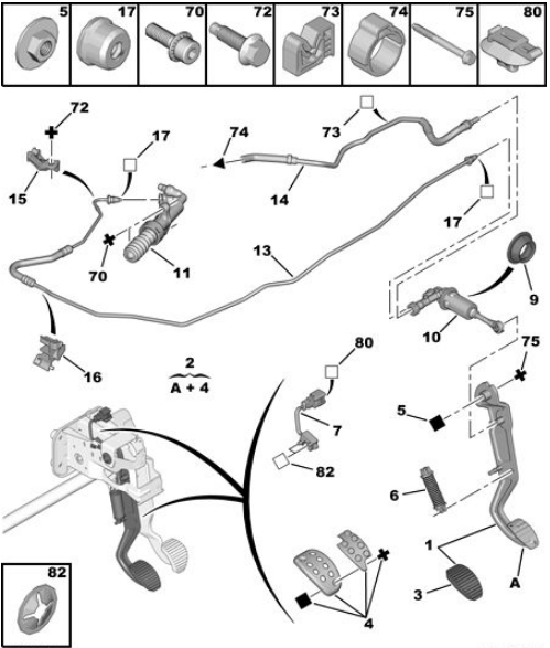

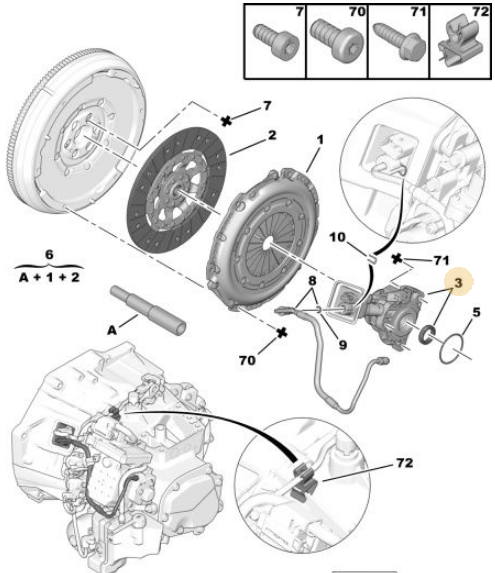

GiveMeABreak wrote: 13 Sep 2020, 20:22 Ok, so here are the parts for the clutch system on this piloted C4: It's a 6-Speed Piloted Gearbox.
A) Clutch Control Master CylinderB) Clutch Parts
Just let me know the item number(s) from Table A or B if you need any part numbers.
As for the jumping on startup - obviously that is dangerous and needs sorting sooner rather than later. I don't have a solution as personally, I walk run in the other direction when I see one of these systems :shock:
I won't even start to advise what could be wrong as it is likely to be expensive whatever it is withe these as the labour is over 2.5 hours just to replace the actuator. But I would suggest you ring the guys at Euro Car Care (not to be confused with Euro Car Parts!). I know they have worked on these systems when they fiorst came out on the earlier C series models, so it may be worth having a chat and explaining the lunging issue on engine start.
But in the meantime, I strongly suggest you advise Mrs Doo to park on a runway for now just in case :-D
