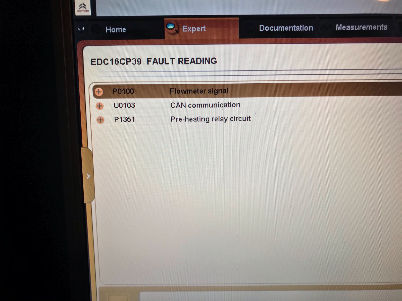

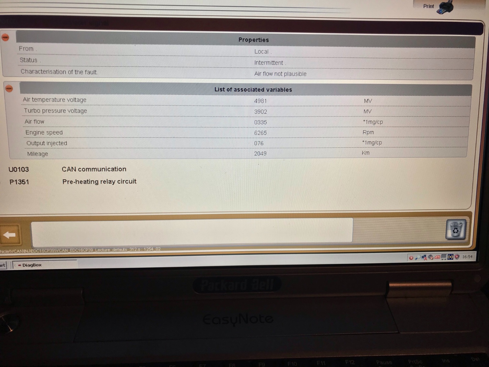

Checking the car on Diagbox, shows up the two faults as per screenshots below. However if I try to delete the faults it comes up with a warning something like ‘fault not cleared’.
I also have a smaller diagnostic reader that shows the same error codes but, oddly, this one does allow me to delete the fault codes. Checking afterwards with the Diagbox shows that the faults have been deleted.
The car then runs perfectly until I execute my downhill-uphill trick again, although it doesn’t happen every time. I should add that checking the DPF on Diagbox shows everything good (Eolys level ok and filter unclogged with not much deposits)

Ignore the P1351 error - that's just the glow plugs, but your P0100 relates to the mass air flow sensor.

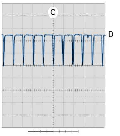

You'll probably need to test the MAF Julian and get some live data. If there is a break or short in one of the wires further up in the harness it should show up on the graph as you wiggle the harness. If the MAF itself was faulty, I would expect the faults and symptoms to be there permanently, but as it only happens on the upward ascent - it might be enough to disturb a faulty wire...
There are 4 wires on the MAF connector:
Terminal 1: FREQUENCY SIGNAL
Terminal 2: Air temperature signal
Terminal 3: Earth
Terminal 4: 12 volts supply
The frequency signal varies in relation to the air flow.
The frequency of the signal decreases as the air flow increases.
Example:
Frequency = 11000 Hz: Engine stopped, ignition on; (No air flow)
Frequency = 5500 Hz: Engine idling; (Medium air flow)
Frequency = 1000 Hz: Engine full load; (Maximum air flow)
As a Reference Graph, this shows Full load engine speed: You should therefore get something similar with the engine at full load.

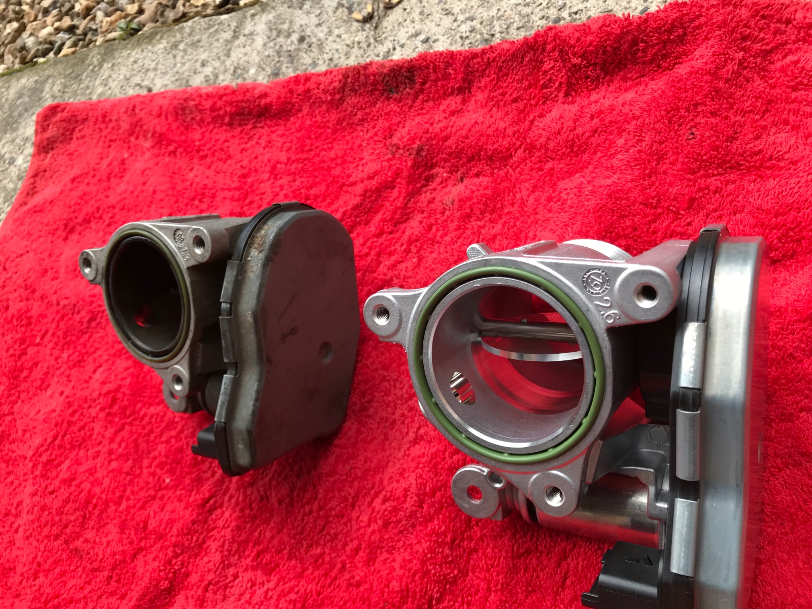

I will do as you suggest and in fact it is the relative abrupt vehicle motion change - from driving rapidly downhill then suddenly hitting the uphill stretch - so this could well be the thing that sets off the poor connection or loose terminal.
Just to check though, is this the MAF on my twin turbo model (Citroen describe this as the Doseur) ? I replaced it a couple of years ago (with a genuine Pierburg unit) as the plastic gear inside had stripped and I guess I may have strained or damaged the wiring.
Cheers
Julian
Many thanks for your speedy and comprehensive reply - as always
Cheers
Julian

Re: Unusual Diagbox result
hi Julian, I too get different success with different code readers! as Marc I dont worry about it too much but it's handy to have a second opinion/attack angle sometimes
that doesnt look like the MAF, the MAF should be engine side of air intake from Air Filter, a plastic black construction with a sensor sitting inside. and a 4 way plug to it, usually its jubileed into the air intake pipework
John
John

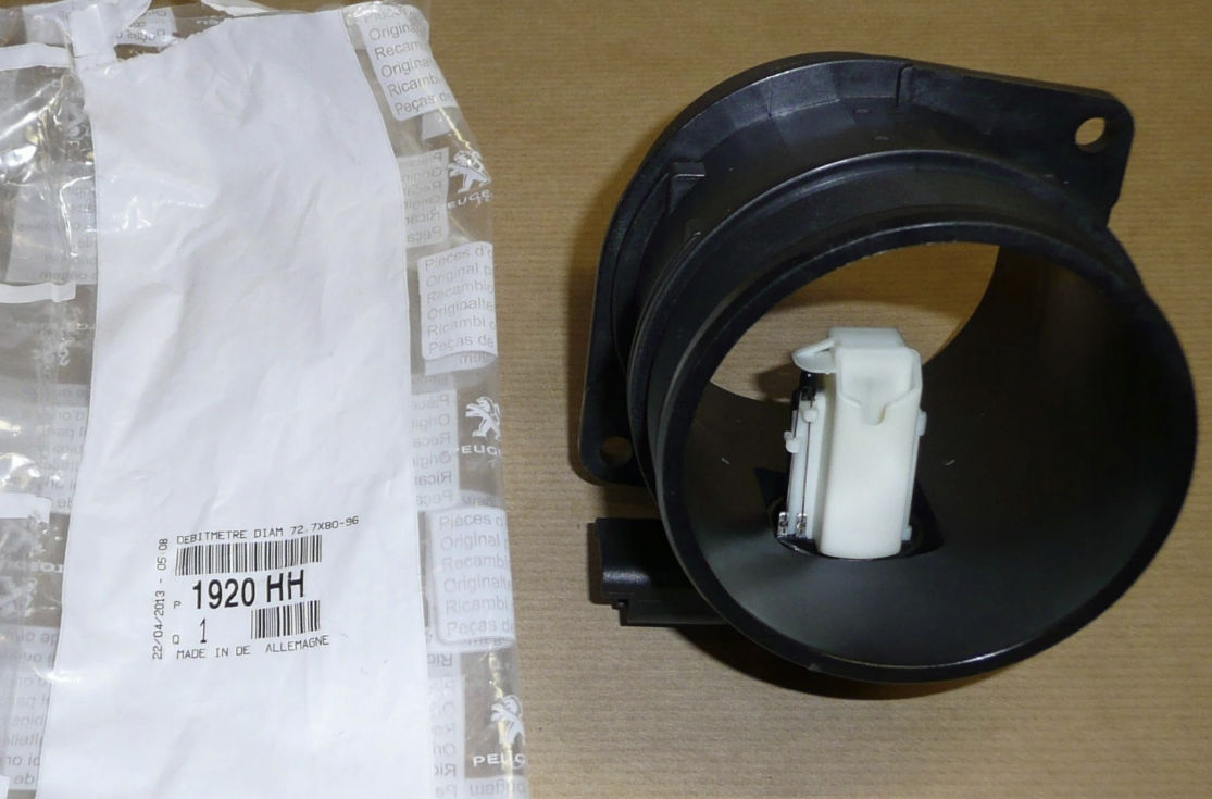

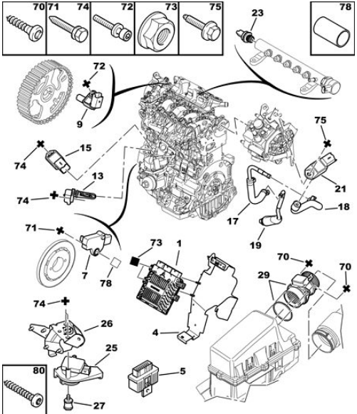

No, not the Air Doser Julian - MAF, which is item 29 below :
Part 1920HH:
Part 1920HH:
Thanks Marc and John,
That’s easier to access
It’s interesting because that doseur also has an air temperature sensor but, of course, by the time the air gets there it’s been heated up by the turbos and then cooled by the inter cooler !
Cheers
Julian
Cheers
Julian
