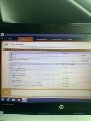

Hi guys,
Thank you for all your feedback.
I’ve managed to plug it in to Lexia today, so please see the attached pictures.

Re: Hydractive not working
Ok, so there does seem to be a communication issue between the Suspension ECU and the BSI. For now ignore the last 2 faults regarding the height sensors as this makes sense if the info is not being received.
Check 2 additional fuses:
The first one is F13 ( Hydraulic Suspension Pump Cut-Off Relay), a 5A fuse in the fusebox along the bottom of the BSI arrowed.
The second is G39 (Hydraulic Suspension), a 10A fuse that should be located to the right side also arrowed and not easy to see. Don't get this mixed up with the other G39 fuse in a bank along the top (Fusebox 'A') - it is NOT this one.

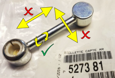

I got finally under my car and to check the height sensor. I noticed the dog bone is really wobbly on the anti roll bar end, but doesn't seem to be broken. (like it's moving left to right about 0.5 cm) Is it supposed to be like that? I didn't dismantle the sensor as I'm not sure if it will (-expletive removed-) up the whole system. Is there a correct procedure to check the sensor wether it's working or not. The lever on the corrector seems to be also quite stiff but am not sure if I should apply any force to it?
Please make sure you support the car independently before getting under - when dealing with height correction issues, the car can come crashing down without warning and crush you.
The height correctors can corrode and water can get inside the unit, causing the track data to become garbled or missing - so difficult to say. The clamp position of the height corrector on the ARB is crucial as this affects the height setting. If it is moved it can affect the height settings, so should be marked with some white paint or similar to note the correct position if you are planning on removing it.
The dog bone can move slightly around the ball itself (left to right) as these just snap on - but they should not move otherwise - see my diagram below:
