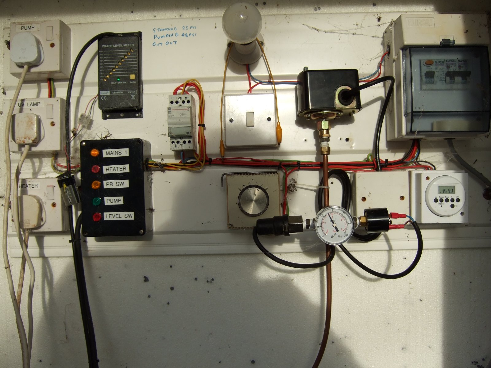

Part of a rig for making biodiesel?

It's a bit more domestic than that Jim.

The clues:
It has a pump which can be switched by a level monitor or it would appear maybe a temp/pressure monitor?
It has a decent sized UV filter through which the liquid is pumped so I am thinking that is to clean the liquid from impurities of the bacteria/algae type
The level monitor suggests a large quantity of liquid, pool or fish pond comes to mind.
It has a heater so again pool or fish pond.
Level is not too critical for a pool. you can top up as and when you need to so I think the water contains living creatures, my guess is ornamental Koi maybe?
Hence its the control system for a large fish pond where cleanliness is important?
Or its the supply for your potable water from a natural spring source, but in that case why the heater?

Your nearest Mick. It's our domestic water supply. We have a well about 25' deep just along side, it pumps the water from there to a 500 gallon tank at the top of the field which then gravity feeds the house.
The extra pressure sensors are part of an ongoing development, having burnt out a couple of pumps due to them running dry, firstly due to the foot valve failing thus draining the system, it's to deep to self prime but OK if you prime it, one sensor is for low or no pressure to prevent the pump from starting, it's a low pressure switch from for a gas boiler, the other one is an overpressure switch should the main one fail.
It has a ball valve in the tank, as the water rises it starts to shut and increases the back pressure which trips the main pressure switch on a latching relay circuit, it won't start up again until the time switch turns it on again at about 6.00am, time switch only stays on for a minute, all sensors are in series with the latching relay.
I took the photos to make up a 'user's guide' in case it packs up when I'm no longer here, I'm the only one that understands it at the moment.

That makes two of us now Peter!! It is not dissimilar to the system Ken had in Mallorca for a similar reason, except his well was inside the wellshed and he had the added complication of a swimming pool and a garden irrigation system to feed , all from the well although the irrigation was supplemented by supply from a huge underground sump reservoir which gathered all the areas rainfall. The domestic water was tapped off the well pump via a holding tank and the whole system was fitted with similar safety measures!!
