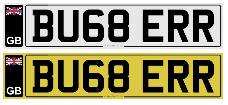

Ok so I'm taking off my private plate for retention and have now assigned my original registration plate.
As my private plates are in poor condition (Halfords, say no more), I will be getting some more made up. Now, this time, I'm dumping the Euro plate symbol and going for a British / Union type flag.
So this is a sample of the design that I really like (and this is also a sample registration). To my knowledge, there is nothing I can find telling me there has to be a blue background for the flag part. That was only applicable as far as I can tell for plates displaying the Euro flag, where it specifically states the blue background at the end of the guidance from DVLA below.
Does anyone have any reason / evidence why this design would not be legal? Specifically, I'm talking about the black background on the flag part. All the rest (font, spacing, border etc., is legal)

GiveMeABreak wrote: 18 Nov 2020, 17:48 Does anyone have any reason / evidence why this design would not be legal? Specifically, I'm talking about the black background on the flag part. All the rest (font, spacing, border etc., is legal)
With all of the authority of "bloke down the pub" here's a thread from Moneysavingexpert with the assembled wisdom of the internet to call on
https://forums.moneysavingexpert.com/di ... r-for-flag
One of the contibutors made this observation
My interpretation is that if no colour is specified then it is the normal colour of the number plate. I.E. white on the front and yellow on the back. Other wise it is a modification that is not allowed.
Dont think you'll get a definitive answer.....
Little more...
Another thing which may suggest that the background colour of the strip may not be a carte blanche choice is the fact that after much deliberation the Govt approved these plates for EV's.
So
the green background strip for ev plates is specified and approved.
The Eu Flag and the Background are specified and approved
The background colour of the rear plates is specified and approved as yellow
The background colour of the front plates is specified and approved as white
Maybe this infers that any colours which are not specified are not permitted which would rule out a black background to the flag, and it would have to go against yellow for the back and white for the front.

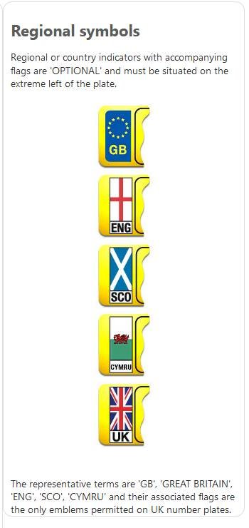

This from a major number plate supplier:
Number plate designs - newreg.co.uk, fair use
https://www.newreg.co.uk/services/dvla_ ... te_designs

No Yorkshire one? :(

Mmmm.... so nothing confirmed to the contrary written regulations wise and a lot of internet waffle as usual as I too have found.
I think I’ll need to fire one off to DVLA tomorrow, as Swansea is not in lockdown, so I’ll ask them to show me where it says I can’t use a black background for the flag strip. Although I still think I’m going to struggle getting an answer.
The website I used is https://www.platesdirect.com/?gclid=Cj0 ... GNEALw_wcB
I chose legal options and that’s where I picked the background, so they think it is ok.
