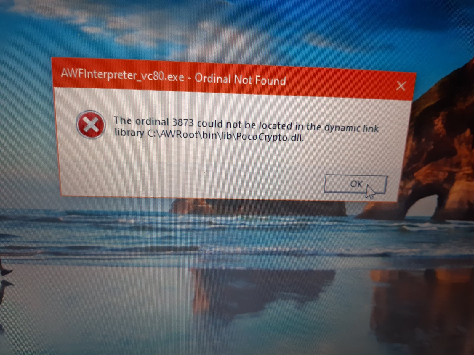

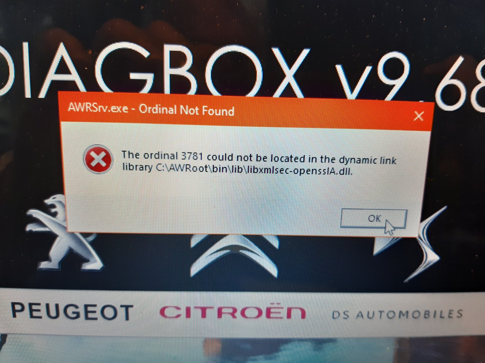

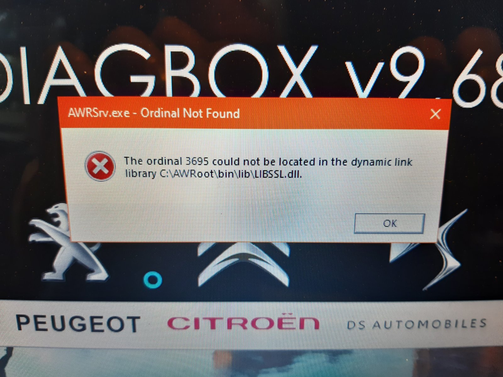

So I'm having a go at installing Diagbox 9.68 prior to activating it by licence purchase. Downloaded it from the mhhauto site and unzipped the files. The first problem I encountered was that the bundled hack to disable Windows Defender simply didn't work. I managed to disable Defender temporarily, until the next bootup, in Windows settings and then went through the Diagbox installation process. Although this took a long time - over an hour, the final screen indicated a successful install. However on trying to run the programme - to see if would come up with an activation screen, it comes up with various 'Ordinals Not Found' - see photos attached and will not load.
I see in Wolfgang's extensive comments - thanks, very useful - that it perhaps will not work with windows 10 32bit - which is precisely what I have - Windows 10 Pro build 1903. Maybe this has something to do with the problem. I am not really interested in changing the operating system as it includes Oracle VM Virtual box inside which I am successfully running Diagbox 7.855 on Windows XPSP3 which is just fine for my old Citroen C4.
I have now managed to permanently disable Defender through changes made in the Group Policy Settings in Win 10 but the problem remains. Where will I find these 'Ordinals'? Any ideas? Wolfgang?

Installing DB 9.68 on WIN 10 32 bit is something for experts and they usually fail too. Rorry himself uses WIN 10 64 bit.
I cannot judge whether the software available at MHH-Auto and the additional programs required completely correspond to the downloads provided by MrRorry.
The pictures are missing ..dll. Maybe the installation will help here
https: // www.computerbase.de/download...-one-runtimes/
The Defender must be elemeniert with WIN 10 - if it becomes active again with a restart, it destroys the program / activation - Rorry offers a program for this.
No DB can work in cooperation with an old DB - everything has to be removed there too.
There is no update for Rorry versions 9.23 and 9.68 and there will probably never be. Each new version requires removal of the previous version and reinstallation and a new activation against payment (50 €).

Well I'm giving up for the moment. Aside from the 'Ordinal not found' issues previously documented it would appear that a necessary requirement is to uninstall Windows Defender. Bundled with the software I downloaded is a file of extras which included, in fact, a couple of uninstall programes neither of which worked. Disabling by changing settings in Win 10 Group Policy would appear to have done the job, but running the Diagbox Manager shows it is still enabled. One way or another I will leave it to others to find out how to install D 9.68. It would appear that, as Kenny suggests, Easy Diagnostics are now selling it , presumably with support, for £80. This may ultimately be the way to go.
