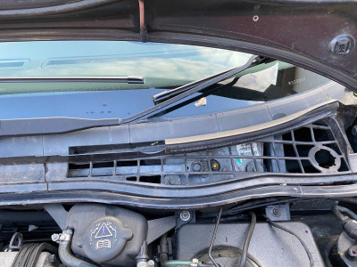

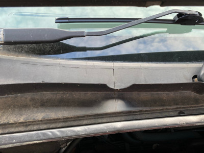

Problem number two which has been festering for a while but has recently come to a head is water leaks... or at least I think it's water leaks.
Many years ago the heater matrix had a slight weep that used to give the typical curry smell when the heater was on and I used Forte Stop Leak on it, and as far as I know that has stopped the leak, however the car has continued to have problems with condensation on the inside of the windows, mainly the windscreen and rear window.
If the car hasn't been used for a few weeks it was always a bit of a chore to get the condensation off the inside of the windscreen etc especially in cold weather... I had sort of assumed that there might still be a slight leak in the heater matrix but recent events have convinced me that I have a rain water leak - and a fairly bad one.
About a month ago when the video in the previous post was taken the car had not been driven at all for over a month and we had a couple of days of very heavy rain. When I went into the car the following day I noticed there was a small amount of water pooled on the drivers rubber mat (about a tablespoon worth) and there were many drips of water resting on the top of the brake pedal...
As I say, the car hadn't been touched for nearly a month and that water wasn't there last time the car was used. When I pulled all the rubber mats and carpet mats out I found the carpets on both passenger and drivers side wet. In particular I noticed that the carpet going up to the right of the accelerator against the wheel arch was very wet, and still is despite a couple of days airing the car in the sun with the windows open.
From what I understand a leaking heater matrix would only ever cause the passenger carpet to be wet, not the drivers side? And not up high on the inside of the wheel arch area of the floor? That seems like there must be water leaking in behind the dashboard as it had dripped onto the brake pedal as well as wetting the carpet up high well above where it would pool.
On inspecting the plastic strip at the bottom of the windscreen it's in pretty terrible shape. It's always had one large crack near the middle right through to the bottom of the strip which has never seemed to cause a problem, but in the last year or so it seems to have developed loads of micro cracks that are really obvious now that I inspect it. See the following photos:
So a few questions:
1) Does the fact that the drivers side carpet is also wet, even up high beside the wheel arch and water drops were found on the brake pedal rule out a leaky heater matrix as the cause? There is a LOT of water in the carpet I suspect, yet the coolant level never goes down - I literally have not needed to top it up in two years, and the car isn't driven much anyway. (So doesn't spend much time with a pressurised coolant system)
2) Would the cracking shown on the strips in the photos be enough to explain a rain water leak behind the dashboard down into the carpets or is it aesthetic only - I've never had that strip off before so I don't know whether it's for looks or whether it plays a role in keeping the window water tight. (Or is that done by a bond on the under side of the glass ?
3) If the strip could be causing the leak, are new strips still available, or would filling the cracks with some black silicone do the job as a quick (albeit ugly) bodge to put a stop to water leaks?
4) If the strip doesn't explain the water leak, where else could it be leaking?
