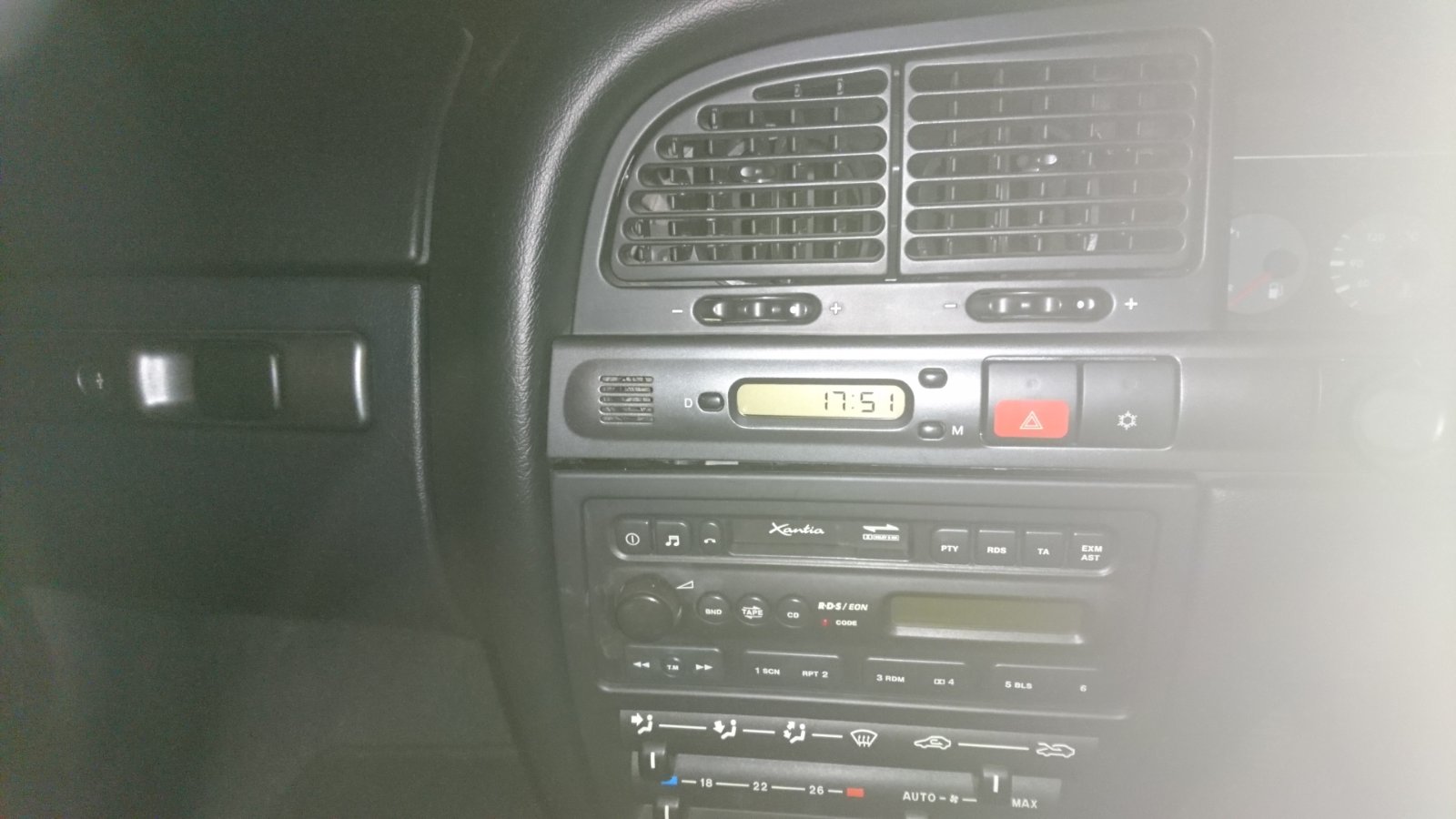

Picture of the grill taken from my car today time can be seen on the clock

Now i have looked at it in situ memory has kicked in, i think that if you remove the radio you can gain access to the rear of the senor/fan assembly, it is much easier than removing the trim panel and i think it is a push fit so will have a tab that need squeezing to remove it but could be wrongadmiral51 wrote: 07 Nov 2020, 17:54 Picture of the grill taken from my car today time can be seen on the clock![]()
*** Edit the pic is from a MK2 but still think radio removal will work on a MK1 ***
