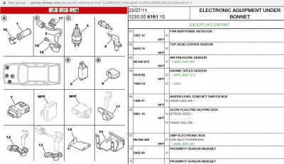

Having difficulty in identifying exactly which of the listed sensors is the correct one for 1905 diesel tacho drive, rather than 1905 petrol timing etc.
The parts page makes it look like 5918.75 (#2) is the right one (and looks the right shape), but is this correct?

Looking at the Peugeot 205 parts list, 5918.75 seems to be correct for the 205 with XUD9.
Does this look like the same part? https://www.ebay.co.uk/itm/BOSCH-0-986- ... 3993378077

That looks right, Mike. Thanks.
Not at all helpful that Cit Parts, under a correct diesel VIN, list what could be/are petrol (1905L and 16S) parts!

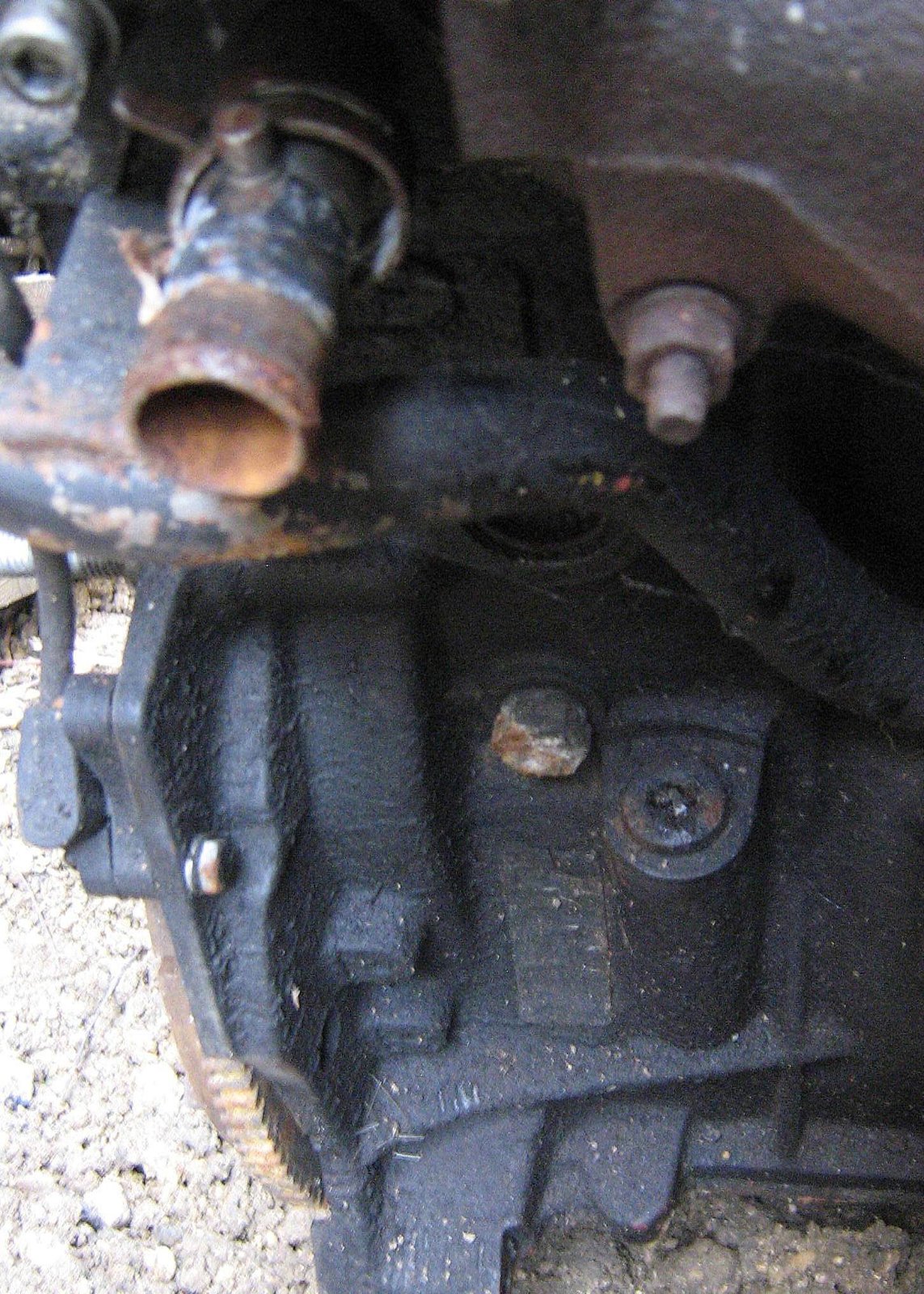

What's the preferred method of setting the sensor position (closeness to the flywheel) in the clamp bracket?
Access to it, engine in situ, is pretty grim.

Surprised you're struggling for access Chris; coz while I'm not familiar with the BX Engine Bay surely its broadly the same as my 405 Bay with the same XUD9A, with perhaps some extra suspension gubbins.
I access it from the top, having removed Battery, Air Box and Trunking.
I've never been fussy about 'Distance from the Flywheel', just push it 'Home' then pull it back a couple of mm.

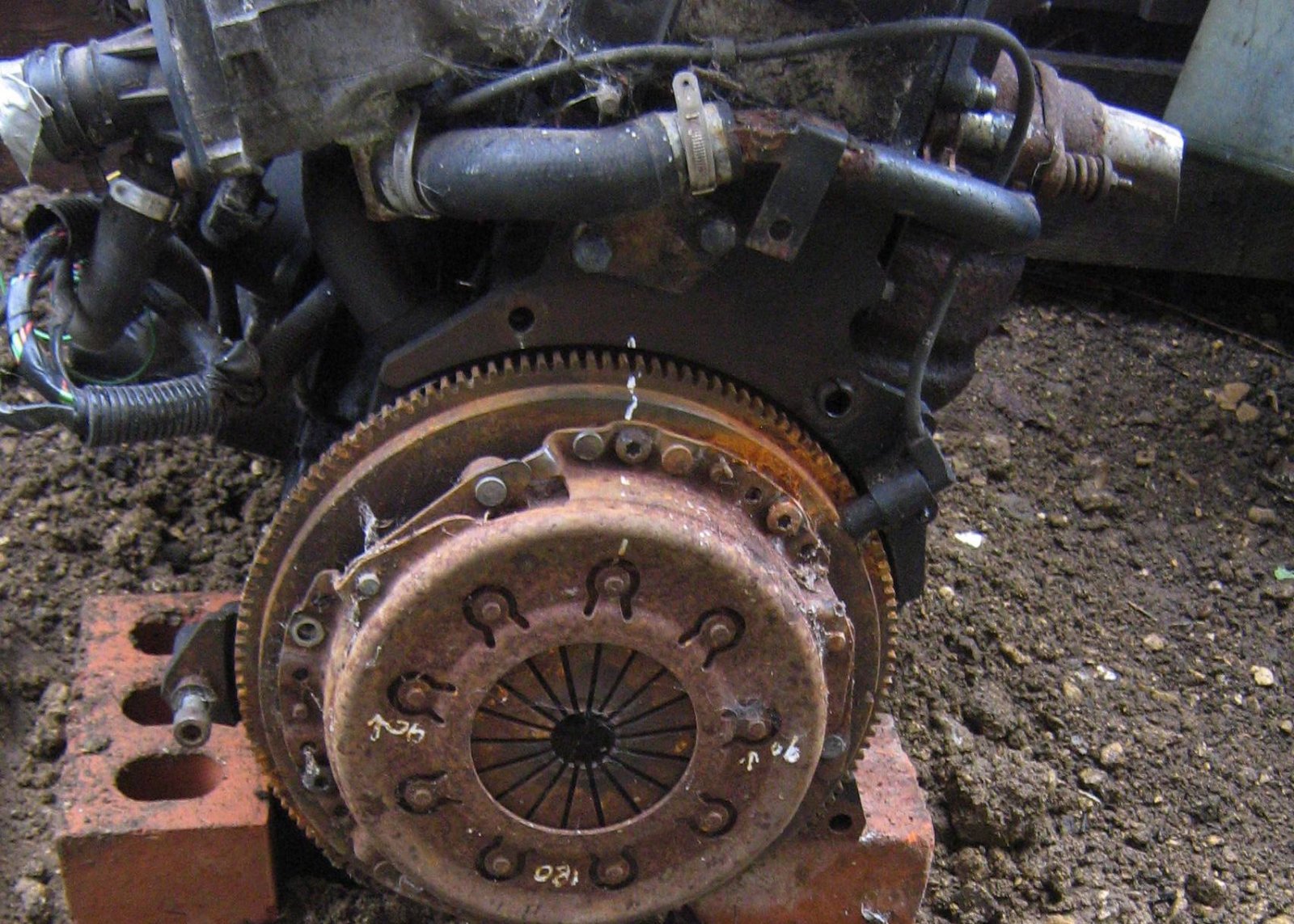

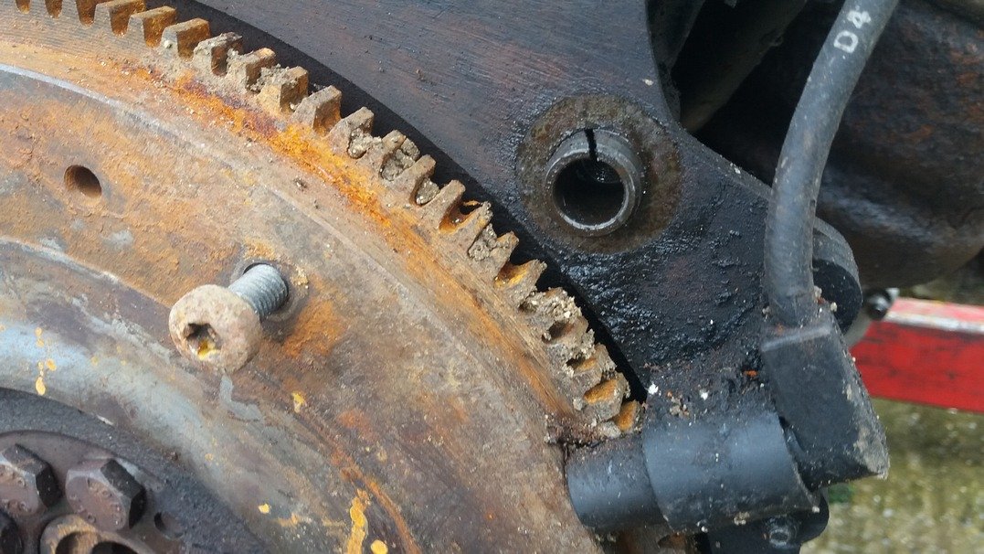

Am I right in thinking that the sensor is looking at the smooth edge of the flywheel (next to the starter teeth), and has ?2 notches machined into it, 180º apart?
Thanks, Puxa. Will take another look. Swinging the HPP pump away helps with access.

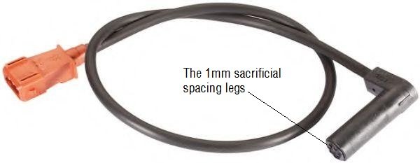

Just found this, in Haynes - tucked away in Engine and transmission - reconnection :
Refit the TDC sensor and holder and tighten the bolts. When the TDC sensor is fitted new it incorporates three legs which are 1.0 mm (0.040 in) long and these automatically set the sensor 1.0 mm from the flywheel/driveplate. When fitting an old sensor the legs should be filed off – the unit can then be fully inserted until it touches the flywheel/driveplate and then withdrawn by 1.0 mm (0.040 in) before tightening the bolts.
Citroen Diesel Engine, 1990 p.76 §28.9

I’m guessing that’s a Cam Driven HPP Pump on the Gearbox side, in the same way as my 1987 309 GRD had the early style Cam Driven PAS Pump
I haven’t looked at my Tacho Sensors in a while, but while I’m not completely sure, I don’t think there’s any notches in ‘em, one of which is new; I can put my hands on em readily, so happy to have a Butchers if you like
Never given any thought to the location, but looking at my photos, attached in case they’re useful; looks like you’re right
Be curious to see the BX bay with Spheres, HPP Pump ‘n’ all that, see how different it is. Guessing it might be old enough to be the ‘early’ layout coz would imagine the HPP pump got ‘moved’ to being Aux Belt driven instead of Cam Driven, in a similar way to how the PAS Pump did on the 405’s
