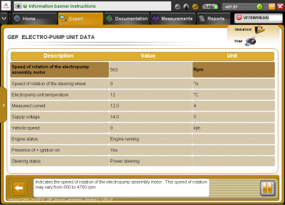

Below you can see screenshots from Lexia. First three are taken when pump is working.
The last one ("Communication error") is when motor is running and pump is NOT working.
What should I do?

Your problem is likely to be with the Fuses, Electrical harness, Engine fuse box or the actual Power steering electropump assembly.
Fault C1209: The ignition+ supply of the electropump has not been detected - so the positive supply is intermittent and when it is, you loose power assistance.
Fault C1211: Vehicle high speed wake-up fault: Not characterised. The likely suspect here is the Power steering electropump assembly.
So that is the common suspect between the 2 faults.
There are electronics inside the power steering pump including the ECU 2 electronic cards. If you've checked the supply to the electropump several times and all looks fine, then the problem is likely to be internal. It can't really be a fuse as that generally will be a Maxi Fuse (MF3) and that also provides power for the radiator cooling fan so if you switch on your Air Conditioning and the fan starts up you know it's not the fuse.
