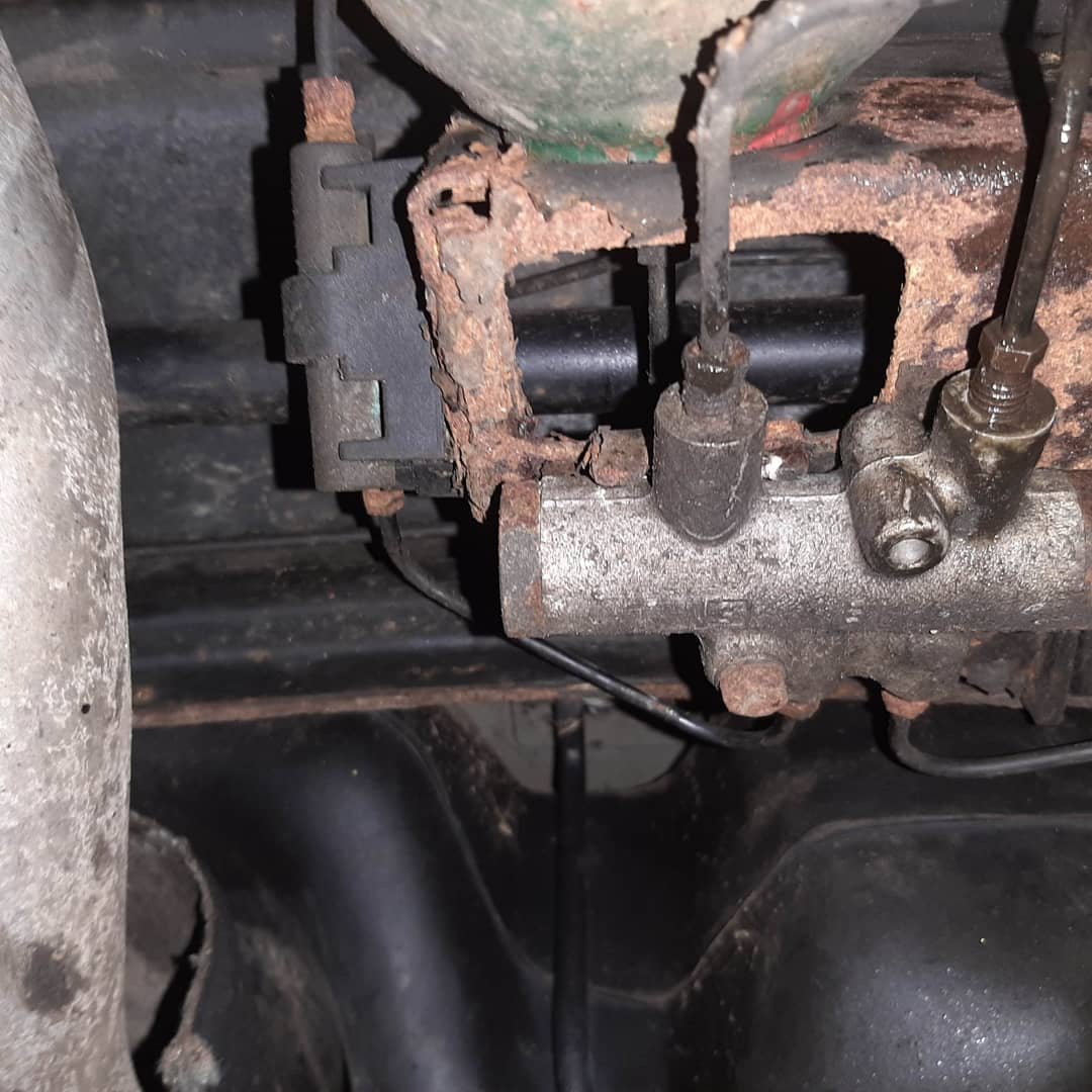

In a very happy place yesterday lying under a Xantia tracing hydraulic pipes to find out the one that runs from the security valve all the way back to the rear anti-sink valve as it needs to have a new section spliced in..

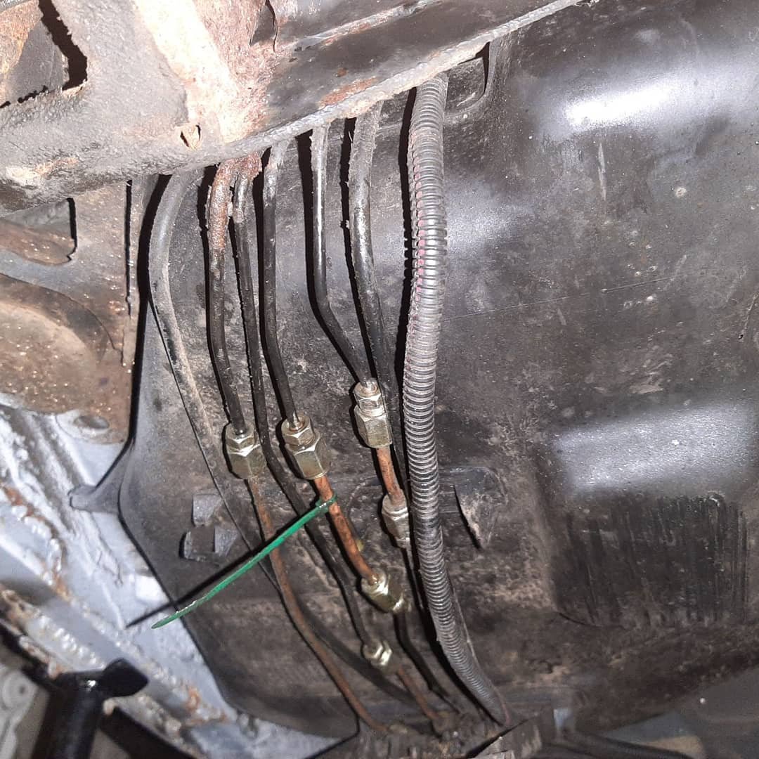

Then we found a four pipes near the rear subframe had been cut and rejoined in the past 😲 Maybe to allow the subframe to be dropped and removed 🤔

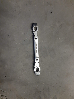

I tried out this very snazzy and clever flare nut spanner on a tight union on the anti-sink valve...
Special spanner
Special spanner
It works magnificently 👍😃

Nice tool :mrgreen:
I would imagine they've either repaired patches of pipes or they've had to drop the fuel tank for some reason - if they'd had to drop the rear subframe surely they'd have took the opportunity to replace those scabby lines - nightmare job getting access in situ although I did manage to replace the same line on mine, hopefully the joiners you've supplied will help Alasdair get that looking prettier .....

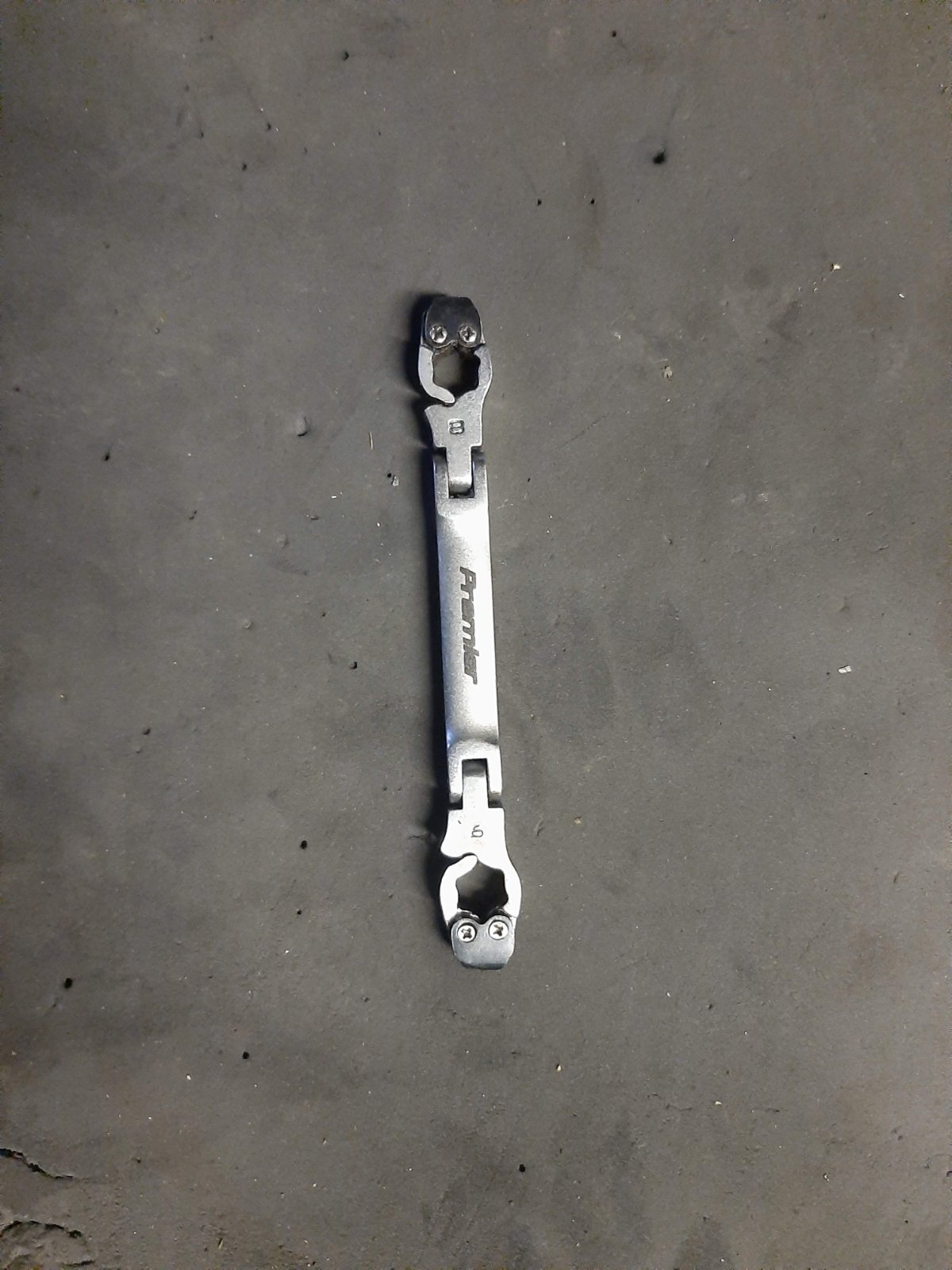

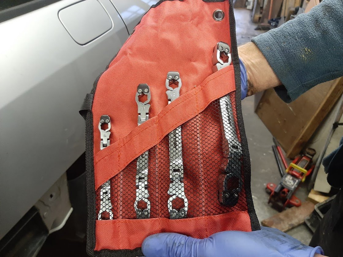

Here's the full set... On the larger ones you can see how the heads of the spanner tighten around the hex as you undo them...
This very much reduces the risk of rounding off a tight one...

You're right about not trusting those couplers... They are a bodge using ordinary kunifer brake line. The joints are two standard flares butted together like a flange... We were both staggered they could hold the pressure!
They will be replaced by the correct couplers... My lathe is going to be busy!!!

They certainly are a good tool, for anyone interested here is an ebay link to them:
https://www.ebay.co.uk/itm/Sealey-VS034 ... 1438.l2649

Thanks for the link to those spanners... They're not cheap are they? :o

Cheap they certainly are not, there are other types and makes on ebay but I get the feeling the Premiers are the rolls royce of the choices, you get what you pay for!! :-D

Precisely 😉 Pay for good quality tools and they last a lifetime and then some. I bought a lot if my tools 35 years ago now, paid for good quality ones and they are all still going strong. I also have a lot of dad's tools and they've now done two generations...

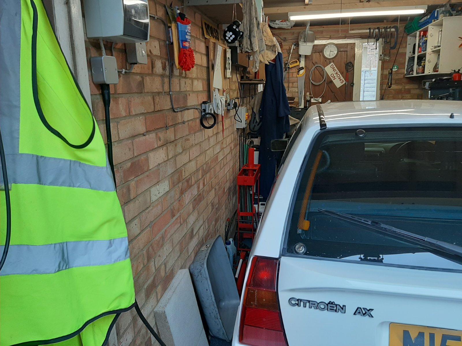

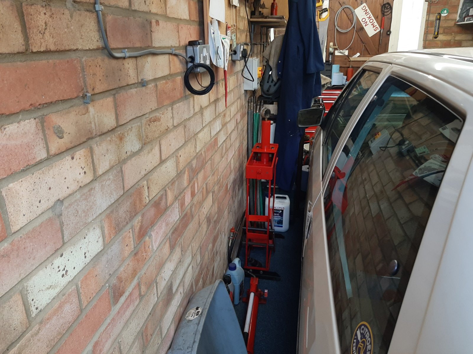

Speaking of tools, I brought my hydraulic press home from long-term loan ready to do Daffofil's wheel bearings... In what looks like a version of automotive Tetris the press has found a neat and tidy home in in the workshop 😎
Ahh, there it is!
Ahh, there it is!
Spot the hydraulic press!
The press is ok but not lifetime quality. I've already impressively bent its press bed after a particularly hard fight with some very recalcitrant XM wheel bearings a few years ago 🤣
Daffodil's little ones should be no problem 🙂

I'll remind you of that last remark when you've got them cherry red with 10 tons on them, and they're still laughing at you!!
