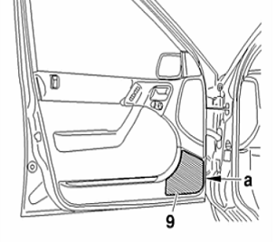

Re: 2000 xantia sx hdi 110 audio system
The speaker grille can be unclipped carefully using trim removal tools. Insert a thin trim removal tool or screwdriver at 'a' and carefully pull towards you to unclip:

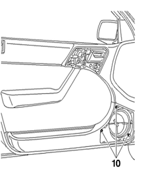

There are 3 screws (at '10') holding the speaker housing in place - but you may not need to remove this if replacing the speaker:
