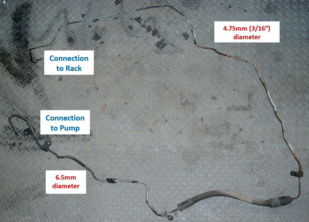

The part we're talking about is item 1 on this diagram
And this is what it looks like off the car
Different versions of the pipe exist for diesel, petrol and V6 engines and the section between the flexi hose and the rack is obviously much shorter on left hand drive cars, but the principles remain the same.
The most common problem is that the section that runs through the nearside wheelarch rusts through, for example here, where it's held by a plastic clip.
The easiest fix is therefore to replace just the section after the flexi hose. This is very straightforward and can be done without any Citroen-specific tools.

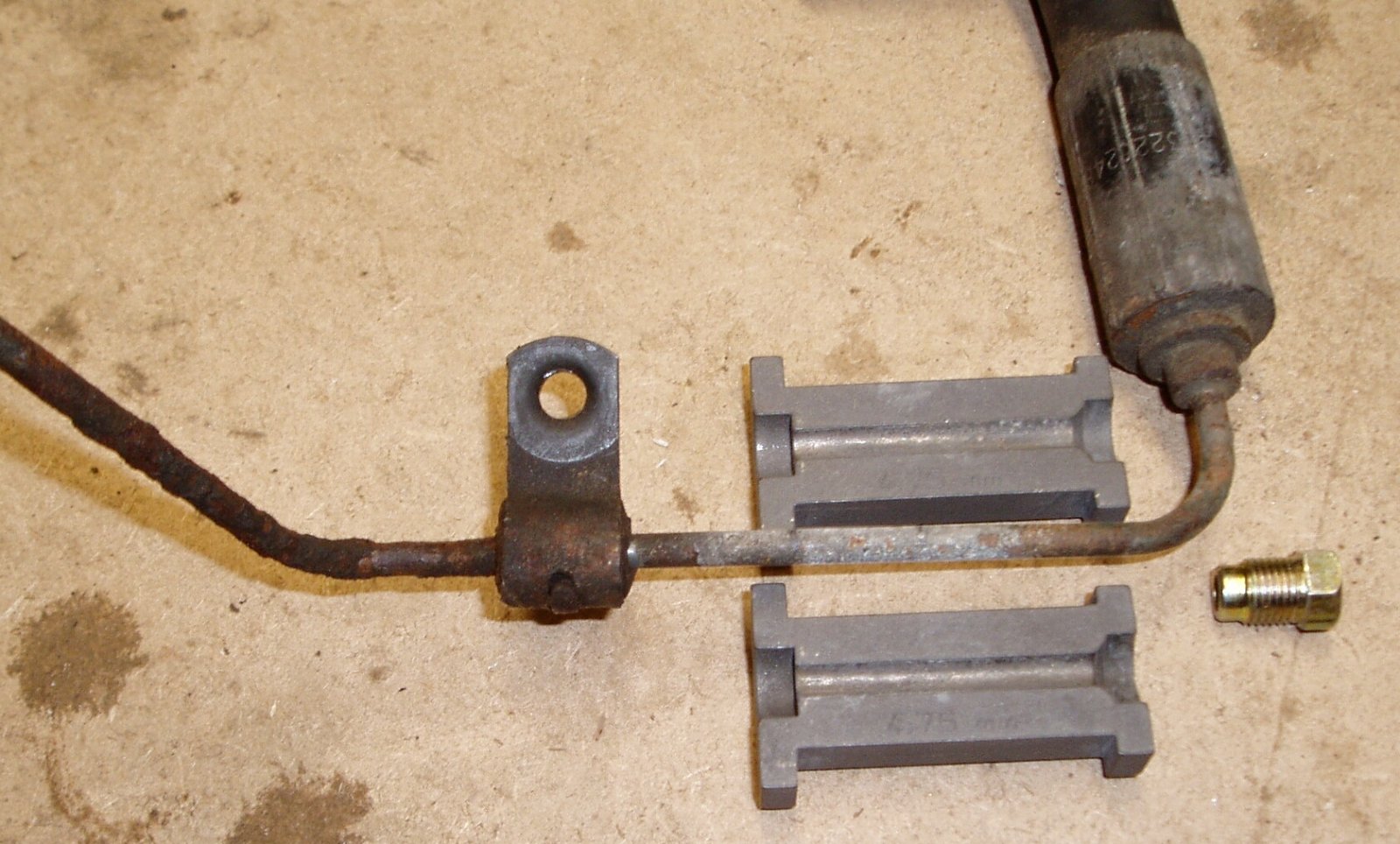

It turns out that the connection to the rack is a standard bubble flare, and as shown in picture 2, the pipe is 3/16", not the 4.5mm or 3.5mm commonly found on hydropneumatic Citroens. Any garage will be equipped to make pipes like this and DIY tools are not expensive.
So, the idea is to cut the pipe about 70mm from the end of the flexi hose, make a bubble flare in the stub of steel pipe, use an in-line union and add a 1600mm (*) section of 3/16" cunifer with a further bubble flare at each end. (* = for RHD cars)
Just don't make the mistake I did the first time and fail to leave enough room to accomodate both the union and the flaring dies at the end of the flexi pipe

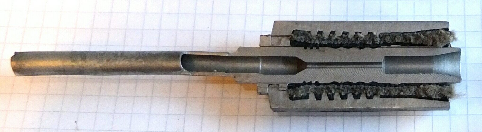

I wanted to understand how the swaged joints between the steel pipe and the rubber hose are made, so I sectioned a joint from a scrap pipe.
I certainly was not expecting to find this 1.5mm diameter flow restrictor built into the joint on the pump side of the flexi pipe.
A couple of poeple have reported on this very forum that they'd noticed pulsing of the steering on full lock after fitting a replacement pipe assembly, which is, I'm sure because this flow restrictor is missing. Ok, it's by no means disastrous, especially compared to the alternative of having a car off the road for want of a pipe, but I think it shows the merit of repairing what you have, if you can.

Kind of a damper I presume, because of the 6+2 pump. There should be an increase of the velocity of the fluid at 1,5 mm section, given the flow and the pressures are the same at both ends of it. So, the goal should be smooth delivery of the fluid to the rackCitroenCrazy wrote: 13 Oct 2020, 20:32 I certainly was not expecting to find this 1.5mm diameter flow restrictor built into the joint on the pump side of the flexi pipe.

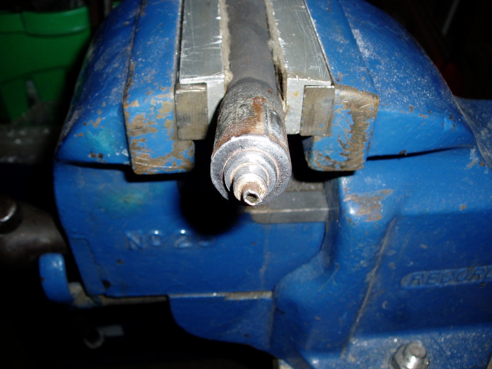

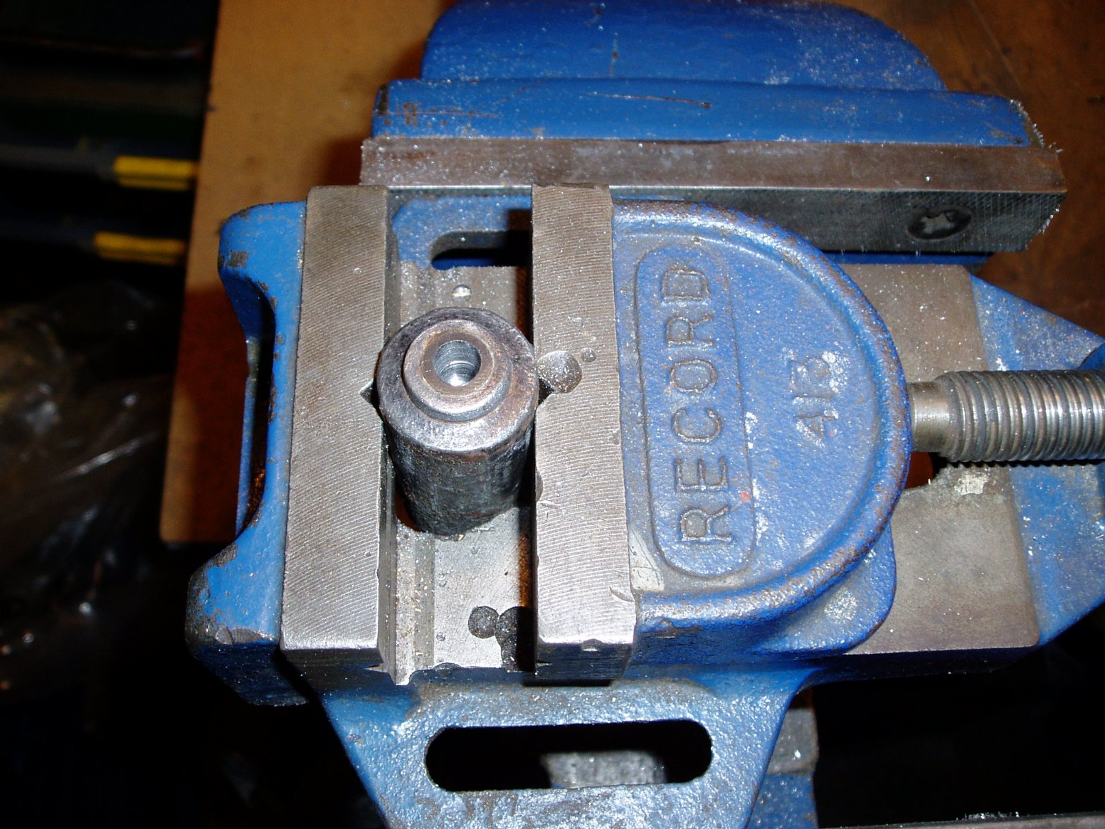

The solution in this case is to drill and tap the swaged joint at the end of the flexi hose, which is just a little bit more involved.
You will need a tool to make a Citroen 4.5mm flare and approximately 1700mm (for RHD) of cunifer in that size
The whole pipe has to be removed from the car.
Saw off the end of the pipe where it exits the swaged joint Drill the end of the joint to 6.8mm, the tapping size for M8, 18mm deep. Don't go any deeper. Tap the hole M8. Use a taper and a bottoming tap. Grease the flutes of the taps to try to retail the chips.
Blow the pipe out with an air line from the pump end
Drill out a Citroen 3.5mm union to 4.5mm.
If you happen to have some of the aftermarket versions with a 10mm head, one of those would be perfect, but the standard ones are ok too.
Put the modified union on the pipe and flare the end in the normal way
My memory is fading here, I think I used a 3.5mm pipe seal, eased on with a bit of LHM. Or maybe I squeezed a 4.5mm seal in, I can't remember.
