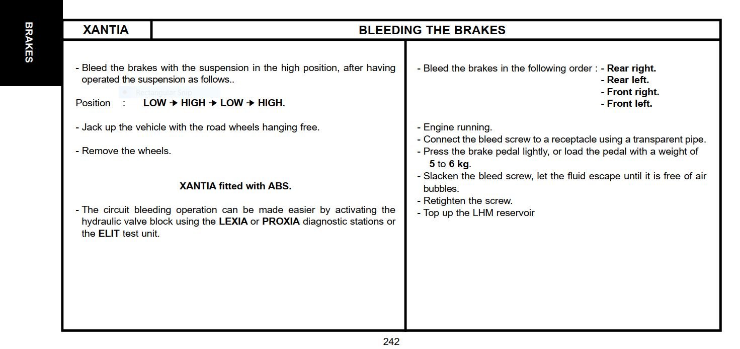

This is the official hydraulic bleeding procedure - from Citroen Mechanic's handbook, Xan-XM-Synergie, 2001
This also bleeds the hydraulic system, after any component (eg a sphere) has been removed.
Rear brakes are fed from rear suspension circuit, as you know.
Suggest throwing 1L of extra LHM into the reservoir before bleeding.
RR bleed screw will draw off the majority of aerated fluid from the system - expect 1L (or even a bit more) from there before fluid runs clear.
Far less from the other three bleed screws.
ABS is self-bleeding, s.f.a.i.remember, so doesn't need special attention.
Length of wood between driver's seat front and brake pedal will keep it lightly pressed.
Check fluid level after it's all done.

white exec wrote: 27 Sep 2020, 10:32 This is the official hydraulic bleeding procedure - from Citroen Mechanic's handbook, Xan-XM-Synergie, 2001
Yes, this is what I'm citing also. Unfortunately more questions are arising in my mind after taking a more through all look at it.
Hope you don't mind, as the additional info you all are providing is great :chin:
1. I have two highest settings, one at the "full tyre" sign, and one slightly before that - the car stays at the same level at both. I know the "full tyre" is the position for changing tyres. Which one should be used for the bleeding, and could there be a malfunction at the level before it (this is the "offroad" setting, right?)?
2. Putting on stands and removing all the wheels is just for better access to the bleed nipples or there shouldn't be any external force at the hydraulic cylinders?
3. I guess I'm getting picky on this, but into the procedure they say, that with Lexia you can open the ABS hydraulic valve block, and if it is self bleeding, could it be, that the ABS will bleed after some time driving and applying the brakes?
4. Pressing the brake with engine running and ABS ECU connected, doesn't opens the separate hydraulic valves onto the ABS block, right?
Generally, it is not that crucial, but still I think it is important and interesting procedure, as it seems, that it has influence also onto the suspension itself.
