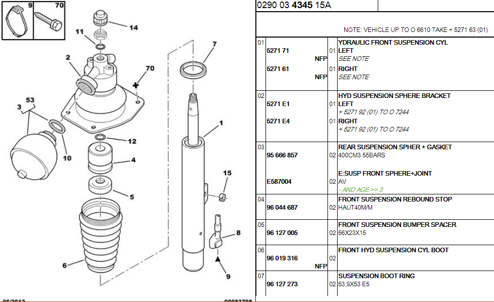

so im thinking the o rings up top there . 11 and 12 maybe , i guess the taper fit should stop leaks , but then the o rings are there for a reason huh ?
x 1750
Re: Xantia mot fail on strut
The two O-rings are either side of the fluid path into and out of the strut and the sphere.
The taper is there for a firm fit between strut rod and the sphere mount, but is not actually 'fluid tight' in itself. The seal depends on the two O-rings.
You look to have access to parts pages, and from the ones I've looked at the two rings are sized as 18mm (I.D.) x 2mm (thickness), and 21mm x 2.45mm - but check carefully via your VIN number (which I don't have), as strut tops and struts do vary across models.
The last time I replaced strut O-rings (on XM), I used Viton quality, and upped the thickness by about 0.30mm to ensure a good seal, simply because there wasn't a lot of squash on the original Citroen thickness dimension. Lubricate well before inserting the strut, to avoid scuffing the rings.
Hopefully, it still might be a leaky return pipe, which does head upwards before disappearing. Clean everything up and dry off to check exactly where the leak is.
Strut top leaks are unusual, but can happen.
