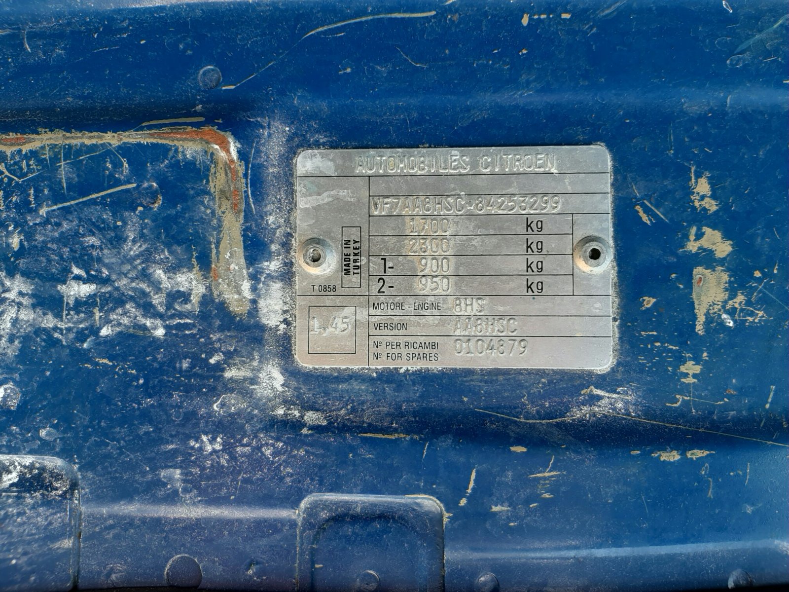

Ok, so no Dual Mass Flywheel on this 1.4 HDi 70, so that rules that out.
