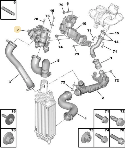

hello guys, the hose marked in the photo is sometimes vacuumed like this. Is it a big problem? why does it, what is the solution? I will be glad if you help. I used google translate. I hope I got understood. citroen c5 2.0 hdi 2010.

I think that's a turbo hose that's delaminated, I think that's the term, its time to replace it anyway

It's the turbo hose
Item no 3
