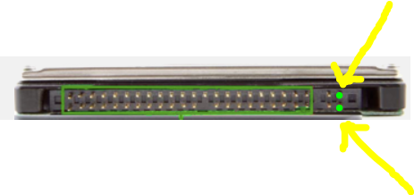

The original Hard Drive will have pins set to configure the HDD as 'Slave'. If this is set to Cable Select or Master it won't boot.
The RT4 is capable of running a USB cable (using 4 out of the 6 pins from the CD changer port). A USB cable can be ordered from the dealer (part 6574JH). A USB memory device can then be used to update system software and maps as if it were reading them from a CD ROM. So you should be able to extract the ISO software update disk files onto USB and update without having to faff with the hard drive. Just get an aftermarket cable to replace the knackered one at some point.

As for the HDD, there should be jumpered pins that set the HDD to slave to the far left that I have marked with green dots.
When these 2 pins are jumpered then the HDD should be set to Slave with the CD as Master for booting and emergency recovery / update reasons or in case of HDD failure where you need to replace the HDD and use the system firmware to repartition and install the OS.

I have the original CD and created an ISO image from that. I wouldn't expect firmware to be copyrighted. Think I will give it a try with an external USB cd reader as i think you are right about using copies of the CD (I am sure there is away around this as I prefer to use flash media rather than CD's for updates). The HDD solution works only if the hd has the 4 pins at the right.
