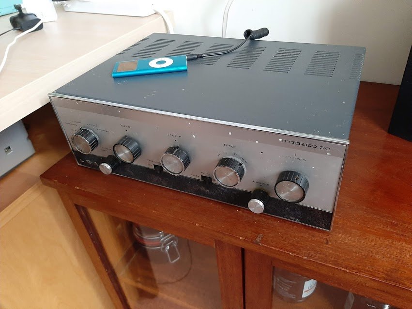

First up was a very scruffy Leak Stereo 30 Amp that had been bodged and 'modified' badly... It was filthy, had odd knobs and blew fuses. After a lot of work to put it back to standard and lots of replacement bits - many elecrolytic capacitors, several resistors and transistors - it is now working beautifully and is in use every day as the amp for both my vintage iPod and a Leak FM tuner. This amp often now in use for 14 or 15 hours a day! I did a small mod of my own to it to make it more suitable for iPod use...
Leak Stereo 30
Leak Stereo 30

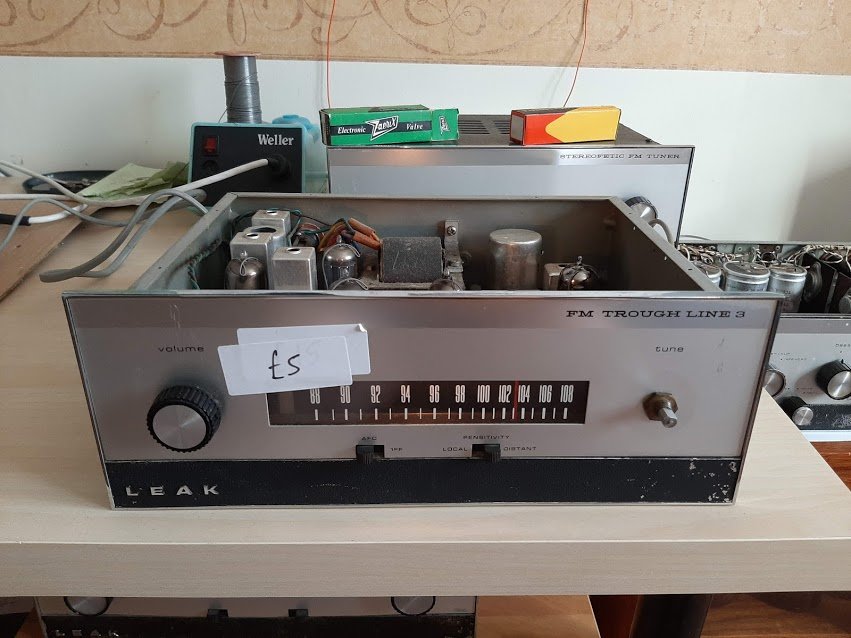

Next up was an equally scruffy Leakl Troughline FM Tuner. Again, just bought for spares as it had several valves missing and a missing knob.
Several valves, a few resistors and capacitors later and it's as good as gold :D It still wears its '£5' sticker - what it cost me - as I cannot remove it without damaging the fascia...
Leak Troughline II
Leak Troughline II

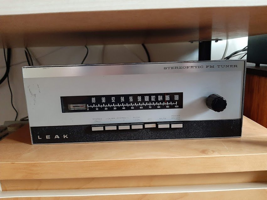

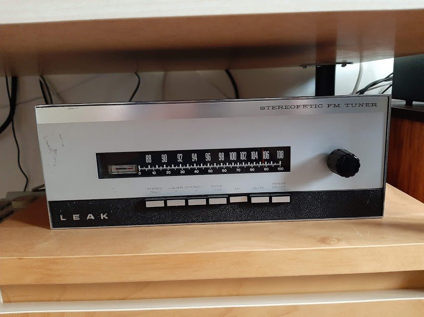

The problem with the Troughline is it's a mono tuner so wanting a stereo version I acquired, via the 'bay, a non-working Leak Stereofetic. It's called that because it's a stereo tuner and was a very early adopter of FETs (Field Effect Transistors) instead of valves in the front-end. It was always known as the 'Stereopathetic' :lol: as it's not tremendously sensitive but given a good signal it's fantastic.
All it needed to make it good was a full RF alignment and a couple of capacitors...
It's now the main signal source into the Stereo 30 amp :D
Leak Stereofetic
Leak Stereofetic

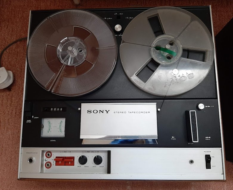

A reel to reel tape recorder was next up. A Sony TC-255... This one needed no electronic work but needed lots of mechanical TLC on the deck due to worn belts and dried-out grease. It needed a new VU meter and I was able to source one from the 'bay...
Sony TC-255 Tape Deck

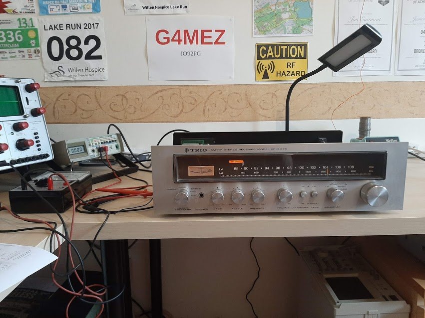

This Trio Tuner/Amp was given to me by a friend for therapeutic purposes. It was incredibly filthy after being rescued from a skip! It needed a good bit of TLC including an IF Transformer and an IC... It's good now :D Back in the early 70s it was quite desirable...
Trio Tuner/Amp
Trio Tuner/Amp

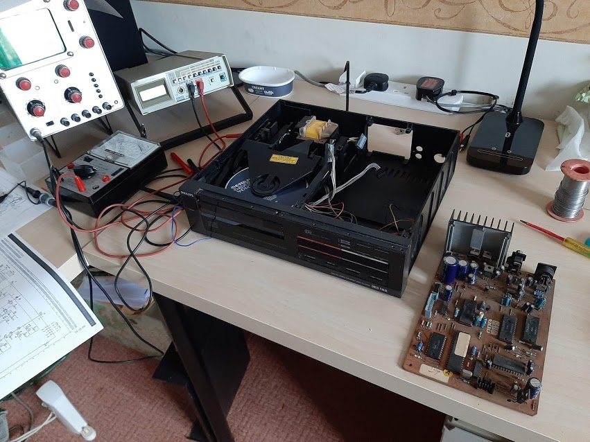

And the current project ongoing is this early Philips CD player... It mostly works but is a bit edgy and fussy about what discs it will play... I'm getting there with it and investigating a problem with the spin motor speed regulation. The spin motor does exactly what it says and spins the CD around at high speed :) The thing is that it has to spin it at different speeds depending how far into the track the laser is and they can struggle to spin the disc fast enough as the laser tracks toward the outside... Unlike vinyl discs, CD's play from the inside out...
Philips CD150
Philips CD150

Try spraying that £5 label with some isopropanol alcohol (if it would not adversely affect you, Jim), let it soak in, and then see if (with care) that label will come off. You might need a few applications of IPA for it to work.

Hell Razor5543 wrote: 05 Sep 2020, 19:25 Try spraying that £5 label with some isopropanol alcohol (if it would not adversely affect you, Jim), let it soak in, and then see if (with care) that label will come off. You might need a few applications of IPA for it to work.
James, thanks! That's worth a try. I do have some label remover but I'm very allergic to it so cannot use it. Goodness only knows whats in it. It smells very strongly of oranges...

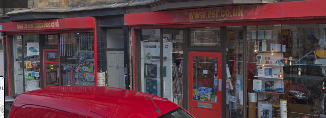

That’s a real blast from the past John surprise i used to often visit aitken bros “when I were a lad”. Great place and fondly remember my father buying me an airband radio to listen to civiliian aircraft comms from Newcastle airport.
Happy memories. I’m luck enough to still have a similar shop not far from where I live ESR in cullercoats.....a similar Aladdin’s cave... top staff...

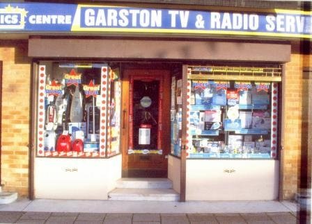

We too were well stocked with component shops. I started my working life as an 11 year old with a Saturday job in TT Reedy (1954) Ltd. which was a TV/Radio shop at 273 St Albans Road Watford. I used to help the resident TV engineer with repairs on the sets which he had collected during the week being unable to repair them on site. He used to do the fault finding and then tell me which components to replace and I would do the donkey work while he carried on with the next set. I learnt a bit about fault finding and a lot about soldering!! :) Then as a member of BT's Special Fault Investigation (SFI) team I spent many hours visiting EGE Components, Garston Radio, Harrow Radio and Langley Road components seeking various components for building mods or workrounds for a failure we had been lumbered with. I believe my final visit to Garston Radio
BFTW
BFTW
was about 30 years ago when I bought the components to build my own windscreen wiper delay board for my Lancia Beta Coupe. A simple parallel RC delay circuit with a series rc timer once triggered. (If that makes sense? :-D )

mickthemaverick wrote: 06 Sep 2020, 12:58 I started my working life as an 11 year old with a Saturday job in TT Reedy (1954) Ltd. which was a TV/Radio shop at 273 St Albans Road Watford. I used to help the resident TV engineer with repairs on the sets which he had collected during the week being unable to repair them on site. He used to do the fault finding and then tell me which components to replace and I would do the donkey work while he carried on with the next set. I learnt a bit about fault finding and a lot about soldering!! :)
Gosh Mick, we have a lot in common :D That's exactly how I started my career! I fairly quickly learned fault-finding and the shop used to save all the difficult ones for me. Especially dual-standard colour TVs... The shop sold a lot of Philips G6 chassis models in the early days and all the regular engineers hated them. I got to love them and can still find my way around them. I also got very skilled with the BRC 3000/3500 colour chassis too... They were our bread and butter.
When there were no tellies and radios to do there would always be a pile of 8-track cartridges to untangle and rethread ~:)
Happy days :D I used to fancy the shop owner's daughter something rotten! She was the same age as me but she went to the posh school so any chance of a romance was doomed - she could not be seen to be going out with some oik from the local Secondary Modern :lol:
