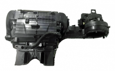

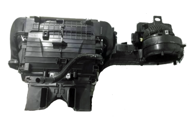

Unfortunately PSA don't sell the evaporator separately. It is part of the complete housing:
So getting this out is a dash off as you'd expect. You haven't mentioned the issue / symptoms. If you are getting only hot or cold air on one side it may be the air mixer or air distribution motors or the gearing.....
