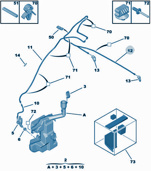

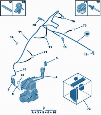

Result! Today I decided to change the camshaft position sensor and the upstream o2 sensor. I also cleaned the vvt valve. After this I hooked up lexia and reset the autoadaptives as per lexia instructions.
The hesitation has now completely gone and the car reacts to the throttle as it should, no kore dangerous situations. Happy me! On to the next thing. Front washer piper has become brittle at the place where it is attached to the bonnet first (driver's side corner) where there is a bend in the pipe. Want to either replace the pipe or just fix it with some tape or the likes.
have a part number here? Maybe just buy some piping and replace it with generic ones?
- x 6957
Re: Citroen C5 X7 throttle hesitation
Hi Robert. That's great news, glad you have finally pinned it down and that may help others in future, so thanks for the update.
As for the washer parts, the piping is cheap enough to buy and cut to needs with various tubes and connectors readily available on the after market, but in case you want parts for OEM stuff, let me know the item numbers for the bits you want:
