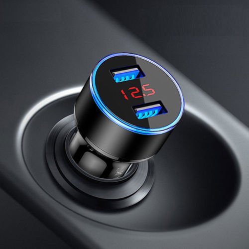

I have been using one of these for a while to confirm that all is as it should be and found it useful.
Also cheap
Also cheap
