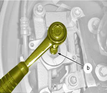

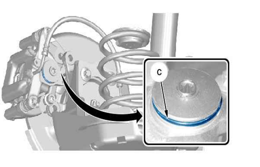

Well this is not good news with this system. The only way recorded is:findmak wrote: 20 Aug 2020, 21:24 Thanks Marc, will give them a call in the morning.
Just thinking how I will get my car to the dealer as the back wheels are not releasing.
Disconnect the battery (follow BSI Reset / Battery Disconnect / Reconnect Procedure).
Raise and support the vehicle
On each side:
- Disconnect the connector (at "a").
- Close rear motorised brake caliper actuator connector using cleanliness plugs.
- The bolts (2)
- The rear motorised brake caliper actuator (1)
Refitting the Actuators
CAUTION: Always replace the seal (at "c").
Refit:
- The bolts (2) (New)
Connect the connector (at "a").
Return the vehicle to its wheels.
Reconnect the Battery following the relevant part of (BSI Reset / Battery Disconnect / Reconnect Procedure)
So if this is not feasible, and you cannot release the handbrake by keeping your foot on the footbrake and pushing the electric parking brake lever, you may have to follow this procedure or get it lifted onto a flat bed truck and have it towed there.
