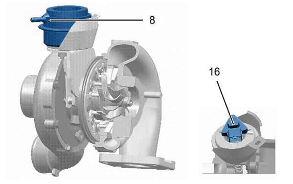

and here is the location of the turbo position copy sensor (16)

Hi thanks for that as my turbo position sensor stays at 11% regardless of load would I be right in assuming that is the likely culprit as would assume that position should change whilst accelerating
Thanks
Mark
x 6955
Re: P2562 & P0299
Have a look at checking / cleaning the solenoid first - these have filters inside that can become blocked up and is a quick check. You can also user a pressure test to see if it is working properly before looking at the turbo position sensor@
