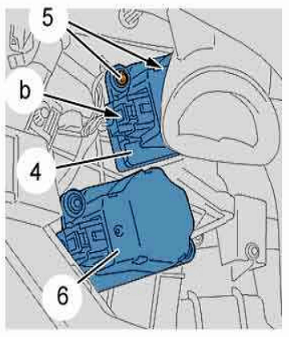

Number 6 is the mixing flap on the right hand side. If you take this off, you may very well still see and be able to turn the gear with a screwdriver, but what you won't see is that inside it may have broken along the shaft and therefore is not connected.
