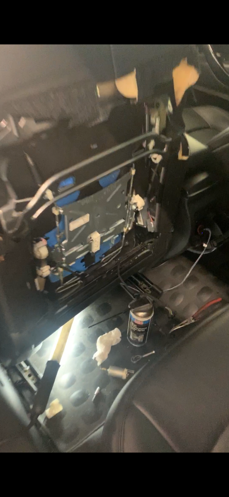

a couble of weeks later i realised he was sort of right, the massage function in the drivers seat was acting weird, turning off after 2 seconds of usage.
i took the seat out of the car and took it apart. ONLY to find out that on the vertical motor for lumbar support wassent running stable...
i diagnosed and came to conclusion that the Plug is defective. (after checking motor and wires)
i inspected the plug and saw a, hold on... Audi/WW logo. i giggled like a little girl, i found a spare connector that my brother has in his shop and cut 5cm off from the original plug and soldered on a new plug.
and like "Magic" everything works perfectly again.
Cleaned and lubed everything fresh.
i took a funny video to show my Boss that he was "Almost" right
i went to him and said: "Hey, you were right about the electronics in my car" He laughed and said: "I told you to get German like the Skoda i drive"
I showed him the video and his face expression went weird, and he just left and didn't talk or email me for 3 weeks.
My Brother who owns the shop i loaned some space in, was laughing his bottoms of when i showed him the plug.
A French car, and first issue i have with it, is a German plug.
(Photos attached, pic with seat inside the car was for testing with power.)
