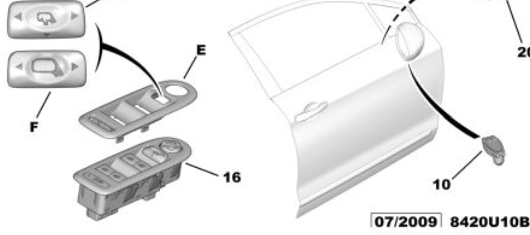

Correct, no configuration changes in Diagbox, so by process of elimination, you should start with the control panel first, it can be removed with a flat plastic blunt trim tool. There are some clips that you can see around the edges shown in the diagram, item 16.
What you’ll find is that water can get into the unit from rain when the door is opened and shut or via the open windows. It can cause the contacts to become calcified or rusted. Get some contact cleaner specifically for electrical contacts and give it a clean with an old toothbrush. Be very careful with the electronics as these are a fair bit to replace if damaged.
I would not suspect the wiring in the door panel, because the driver’s door control module would need to work to operate the mirrors.
Thank you so much. My car's passenger side mirror was always open. Then I saw your post and check the control panel and see that one of the connectors is not in place. So I just connect it to it's place. Voila it's working :-D =D> =D> =D>
