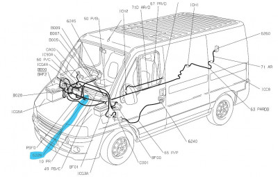

wheeler
- Posts: 7917
- Joined: 21 Sep 2002, 19:07
- x 1056
Re: 2004 Citroen Relay Key Infra Red Transponder / receiver unit Location
There is an electric window/central locking control unit (number 6228 in the diagram), i suspect this will also incorporate the RF receiver. The diagram isnt too clear to its location but it looks like it is between the glovebox & heater unit area, it should have a 24 way black connector on it to help identify but may also have extra plugs.
First thing I would try is re-pairing the remote but I would have hoped the dealer would have already tried that?? you need Lexia for this. Next i would replace the key as you need a spare anyway regardless & take it from there. In general its is usually cheaper to get a replacement transponder key/remote if you already have a working key, if you lose/damage
your only working key its often lots more £££ to get a new one.
Well, I have got to the bottom of this at last. Central locking is now working perfectly remotely and manually.
The problem was the eeprom chip in the RF receiver. I managed to get a new RF receiver and matching key fob chip from a breaker for £45.
This central locking system is essentially a fiat system. No software was required as the chip and receiver unit were working on the van that was broke up in the breakers yard, so they were already paired. If you cannot get a matching key chip and receiver unit all is not lost as you can get them paired but it requires the correct software like Lexia. Normal programming procedures aren’t an option and as there is a chip known as an eeprom chip in the reciever and it needs to be programmed. Work needs to be done to pair them. (specific key data and security codes extracted from the vans ECU or immobiliser and then written to the transponder).
The central locking control unit is sited behind the glove box. You have to remove the glove box and associated panels to get access to it (part number 1356927080) The RF receiver is sited below the paper/document holder in the centre of the dash board that flips up. The radio has to be removed and the 4 screws holding the panel onto the main dash board panel. The RF receiver is held on by 2 screws (part number 1331247080) it has one small multiple pin connector.
I hope this helps someone else out there
