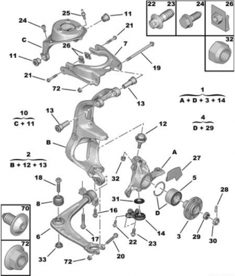

Has anyone purchased Front suspension arms/Wishbones for C5 x7 Tourer ?
What price and where best to buy? noticed many different manufacturers online? any experiences? - i need both front left and right, as bushes have worn. Not sure of part no either? - (steel sprung suspension)

Just let me know the item numbers from the diagram you need parts info for:

Hi Marc, the Wishbone, no 6 i think as per diagram

Re: Front suspension arms / Wishbones
From Citroen these are an eye watering...
Left: 9666244080 £361.63
Right: 9666243980 £367.46
... At least they include VAT!
You can search on the aftermarket with these part numbers now.
Got the pair for 180 in the end, local mechanic did me a favour too, 165 (took them 4.5 hrs!!, paid in the rear apparently!) but with a fresh MOT as well. No more clunky noises at junctions, and nice solid feel over bumps
