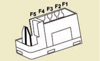

I think I used my electric mirrror fuse on one of the BSI fuse boards for my dash cam project. This is switched live and suited my needs.
Try Heated Seats (F2), Folding Mirrors Relay (F4) in the passenger compartment Fuse Box, or:
Rear Screen / Mirror Defrost (F17) on the lower Row of the BSI fuses:

Thanks for the heads up I will check them - can I ask where the passenger compartment fuse box is hidden? Th user manual isnt exactly specific in the locations :)
Steve
x 6945
Re: Berlingo Fuses - Looking for ignition switched.
Hi Steve it should exist in the same vicinity as the BSI - But the electrical data on the B9 Utility Vehicle is shockingly poor. Each of the Berlingo variants are completely different, which adds to the confusion unfortunately. Sorry I can't be of more help with the fuses - but it may be 'plugged' in somewhere like a connector from the looks of it... :?:
