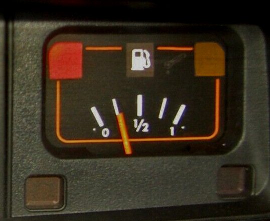

Can someone tell me what is the red light on the left of a fuel gauge the icon it looks like a exhaust overheating or blocked? the car is too old to have a diagnostic tool. What is wrong?
thanks
Fab.
x 6945
Re: 205 1.6 automatic 1992 a warning light come on
Can you put a photo up of the light? Given the age of the vehicle, it could mean something entirely different for the year, but we may have a better idea once we see what it is.

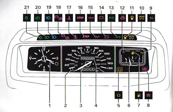

The year is 1992, the icon is number 12.

I am fairly sure that is the engine overheat warning, which would normally indicate a serious problem, commonly low coolant level or failed radiator cooling fan.
x 1746
xantia_v6 wrote: 02 Jul 2020, 21:56 I am fairly sure that is the engine overheat warning, which would normally indicate a serious problem, commonly low coolant level or failed radiator cooling fan.
The photo is not very clear, but if that symbol includes a radiator fan (on the right) it would be an engine overheat light.
A cat overheat symbol is usually just a symmetrical 'sausage' with heat lines.

If you zoom in on it, that is what it is Chris.
x 6945

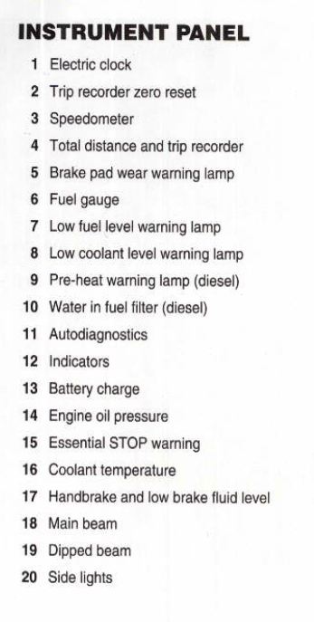

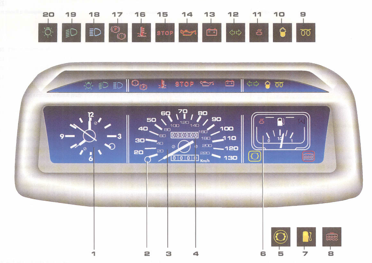

Theflyingpostman wrote: 02 Jul 2020, 17:28 The year is 1992, the icon is number 12.
Yes, so that is actually called 'Autodiagnostics'
The vehicle had an earlier rudimentary diagnostics system.
