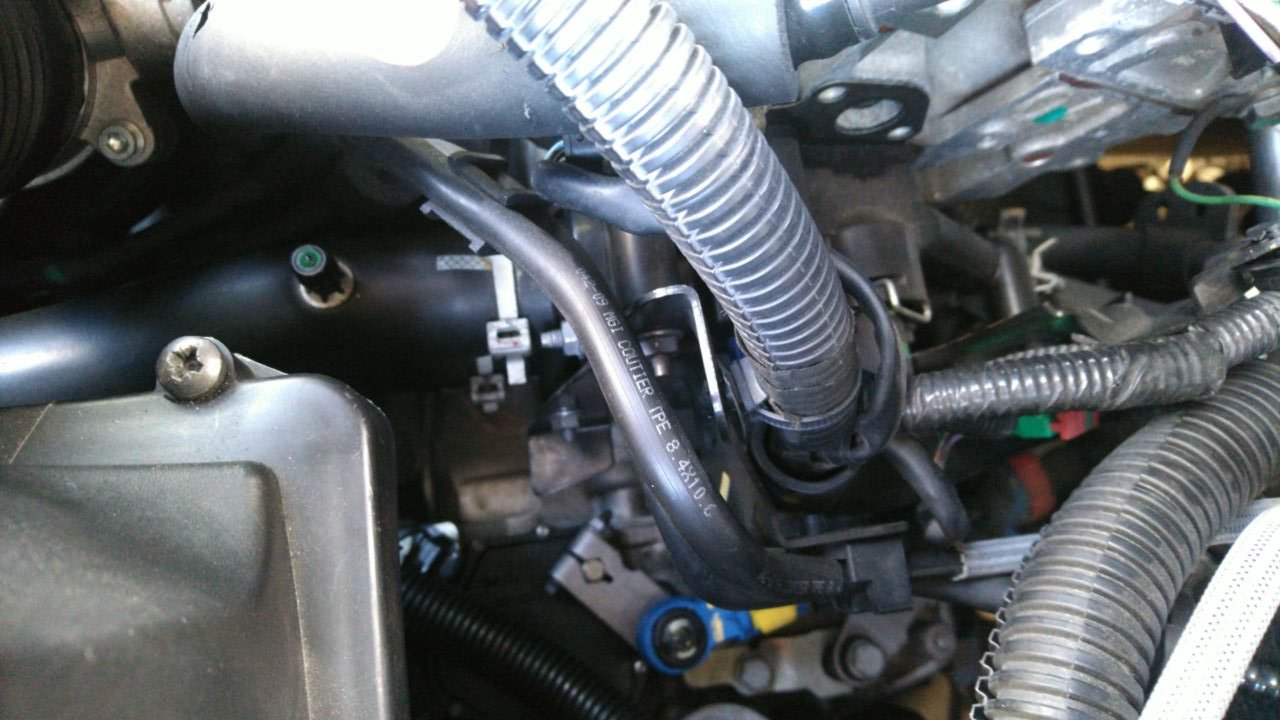

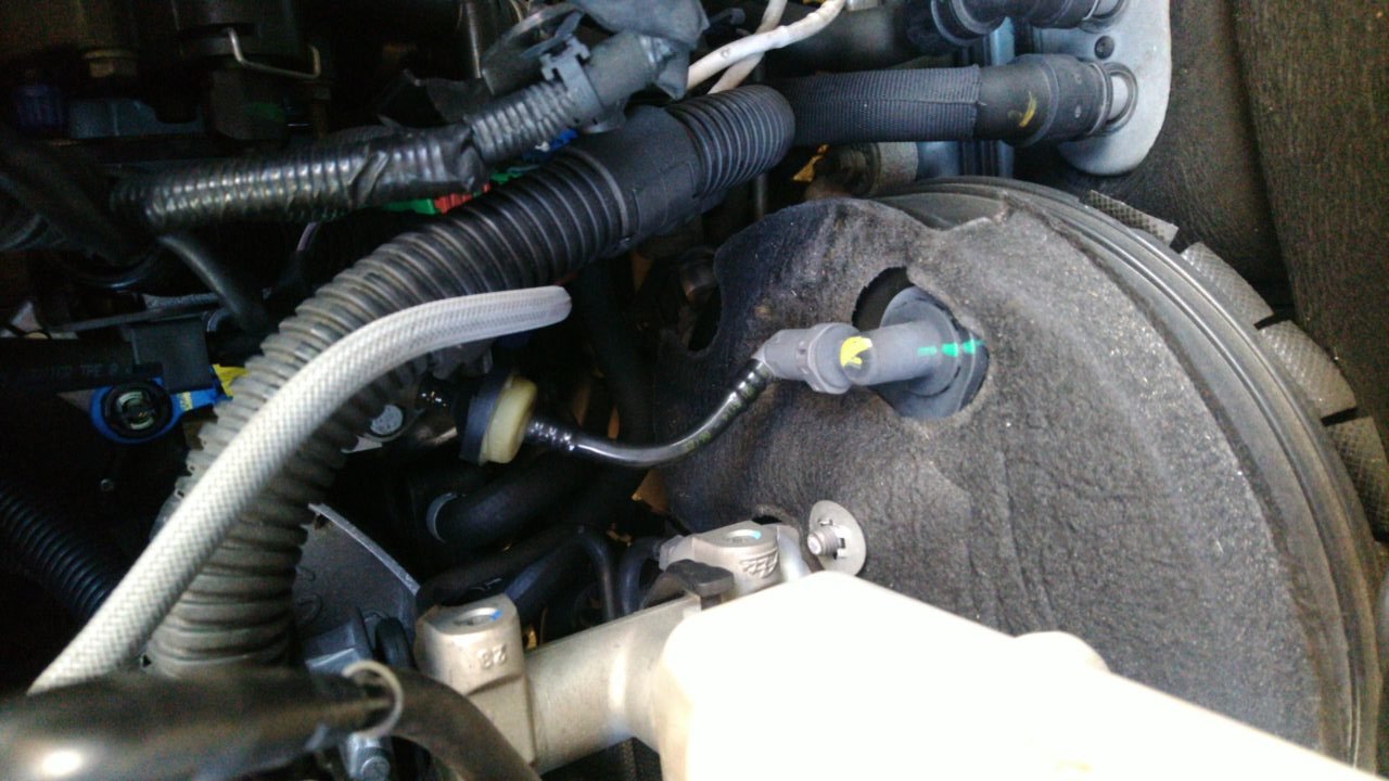

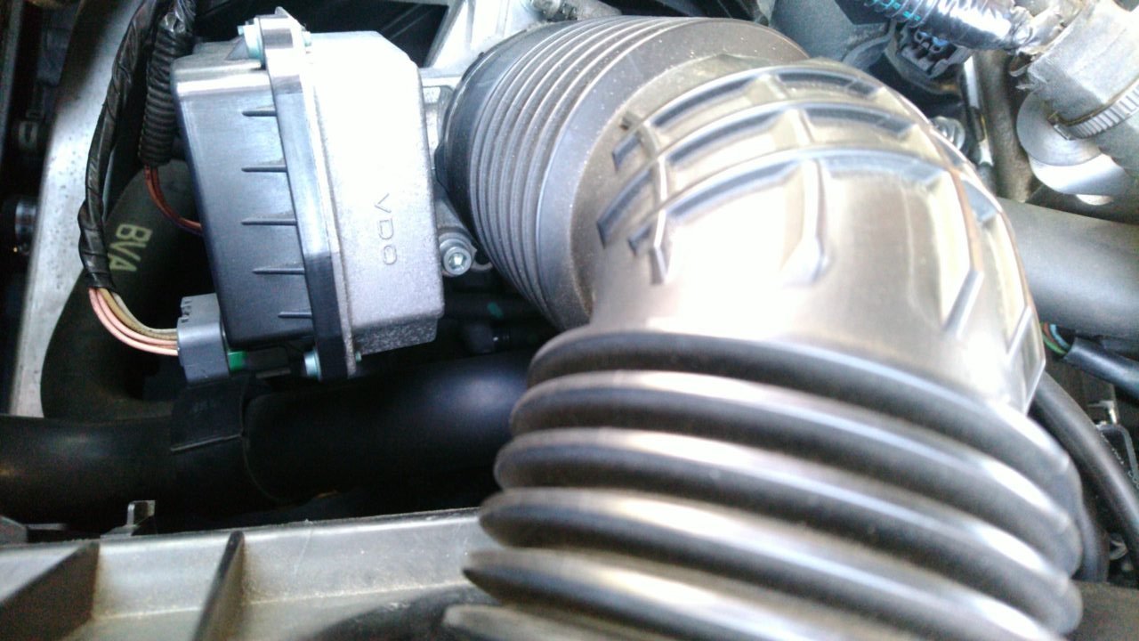

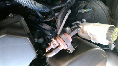

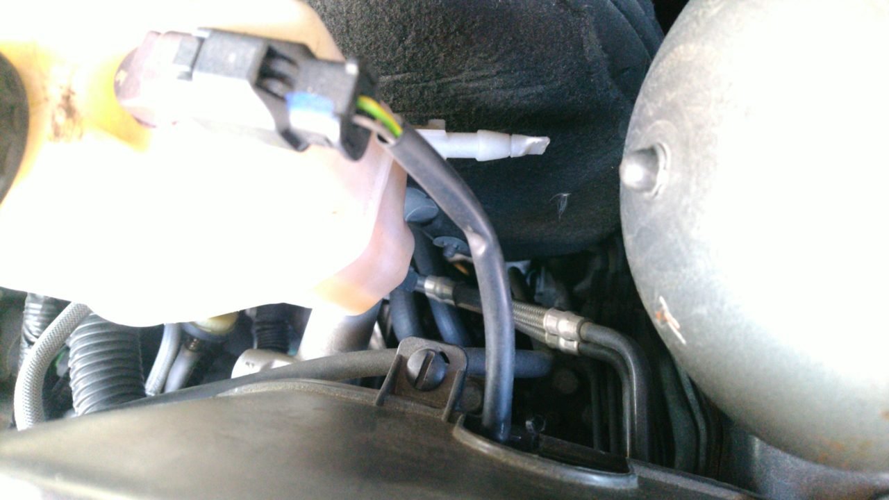

Have added pictures:
tube from brake servo (part number here as well if available):
https://www.famrijken.net/wp-content/up ... 578662.jpg
Bottom tube in this picture, goes to inlet manifold under the throttle body:
https://www.famrijken.net/wp-content/up ... 600319.jpg
Difficult to see, but above the throttle body you can see the 2 vacuum tubes (green paint marking on 1 of them):
https://www.famrijken.net/wp-content/up ... 618135.jpg
Top tube in this picture goes to the mentioned brown sensor (the white braided tube):
This is the sensor:
https://www.famrijken.net/wp-content/up ... 631501.jpg
And the tube from the sensor then disappears, can probably see from below if I lift the car and remove the under engine cover (rainy season here, no roof, so difficult), tube closest to the black box:
https://www.famrijken.net/wp-content/up ... 645804.jpg
Also will need the part number for the breather hose that goes into the rocker cover as I can see some damage here. Visual inspection of the vacuum tubes, they all look in good shape. On start up of car and idling in P and it runs like a dream. Putting it in D and it will idle no problem, driving off the first few metres in a straight line, no problem again. Turning the wheel to make the turn and pressing the brake a little and the car will start to drop revs, ECU trying to recover and this continues for like 5 seconds, I can then drive off as ECU recovers the rpm and then no problem anymore (but for the hesitation at lights at times). Sometimes the ECU is unable to recover though and it stalls. No logged errors, no engine light.

Thanks all. Here again now with the pictures!
guess the above diagram is for the second tube. Where is the canister located? What is the part number for number 6? What does the electro valve do? Do these break down? Part number for this? Hose going to this also coming from inlet manifold, no part number for this then?
tube from brake servo (part number here as well if available): Bottom tube in this picture, goes to inlet manifold under the throttle body: Difficult to see, but above the throttle body you can see the 2 vacuum tubes (green paint marking on 1 of them): Top tube in this picture goes to the mentioned brown sensor (the white braided tube): This is the sensor: And the tube from the sensor then disappears, can probably see from below if I lift the car and remove the under engine cover (rainy season here, no roof, so difficult), tube closest to the black box: Also will need the part number for the breather hose that goes into the rocker cover as I can see some damage here. Visual inspection of the vacuum tubes, they all look in good shape. On start up of car and idling in P and it runs like a dream. Putting it in D and it will idle no problem, driving off the first few metres in a straight line, no problem again. Turning the wheel to make the turn and pressing the brake a little and the car will start to drop revs, ECU trying to recover and this continues for like 5 seconds, I can then drive off as ECU recovers the rpm and then no problem anymore (but for the hesitation at lights at times). Sometimes the ECU is unable to recover though and it stalls. No logged errors, no engine light.
Help appreciated!
