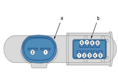

It may be that you have a problem internally with one of the temperature sensors. If the system gets too hot the assistance is limited at 96°C, and if the temperature reaches 108 °C, assistance is stopped.
This system also has a reservoir of LDS fluid internal to the pump to provide a supply.
There is however a backup system if the electronics fail where the power steering will default to backup parameters.
I suggest you first check the electrical connections, especially terminals 1 & 2 to or make sure the plug is tight and there is not water ingress.
Key:
Power connector " a" :
Terminal 1 : + 12 V
Terminal 2 : Earth
Connector "b" :
Terminal 1 : CAN
Terminal 2 : CAN
Terminal 3 : NC
Terminal 4 : CAN
Terminal 5 : CAN
Terminal 6 : NC
Terminal 7 : Ignition+
Terminal 8 : Line
Terminal 9 : NC
If you have a diagnostic code reader (ideally a Lexia), check to see if you are getting fault codes C1203 or C1406. In fact if you are getting any fault codes, post them up.

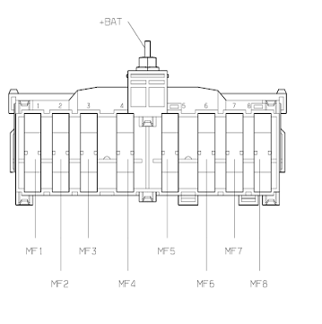

- x 6955
Re: C5 2.0HDI Power steering faulty!
Ok, so definitely worth checking Maxi Fuse 7 near the engine fuse box. This is a 70 Amp fuse that is responsible for the Power Steering Electropump unit on this specific engine.
