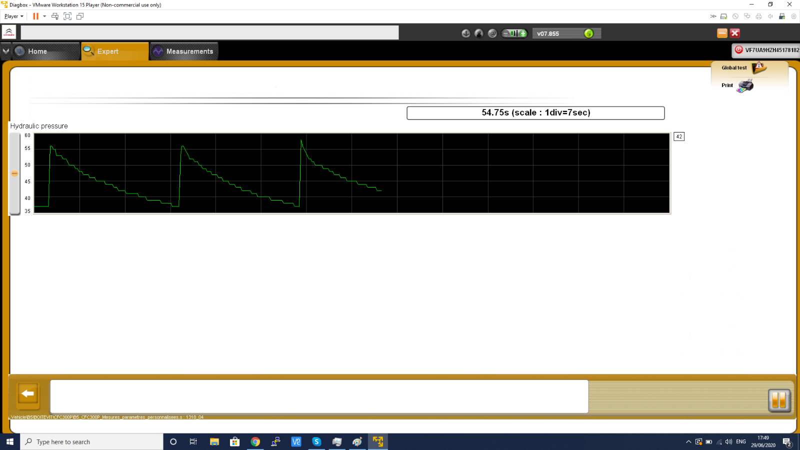

I have Diagbox 7.83 which I have run and the one persistent fault code is P0868. A quick search here points to low hydraulic oil pressure.
I ran the "measurement" part in Diagbox for the hydraulic oil pressure and that does seem to start at around 55 bar and then slowly drop to 35, before shooting back to 55. This repeats and I can hear the motor spinning every 30 to 40 seconds when the pressure goes up
I’ve attached a screenshot here.
My question is, is this normal and do other people see this fluctuation ?
I've cleaned all the area around the actuator and electropump and there doesn't seem to be any obvious leaks and the fluid level stays pretty constant
I’ve run some of the actuator tests and sometimes I can hear the gears shifting, but most of the time I see a message “Conditions not met” before the tests appears to abort
Any suggestions or pointers for further analysis would be greatly appreciated
