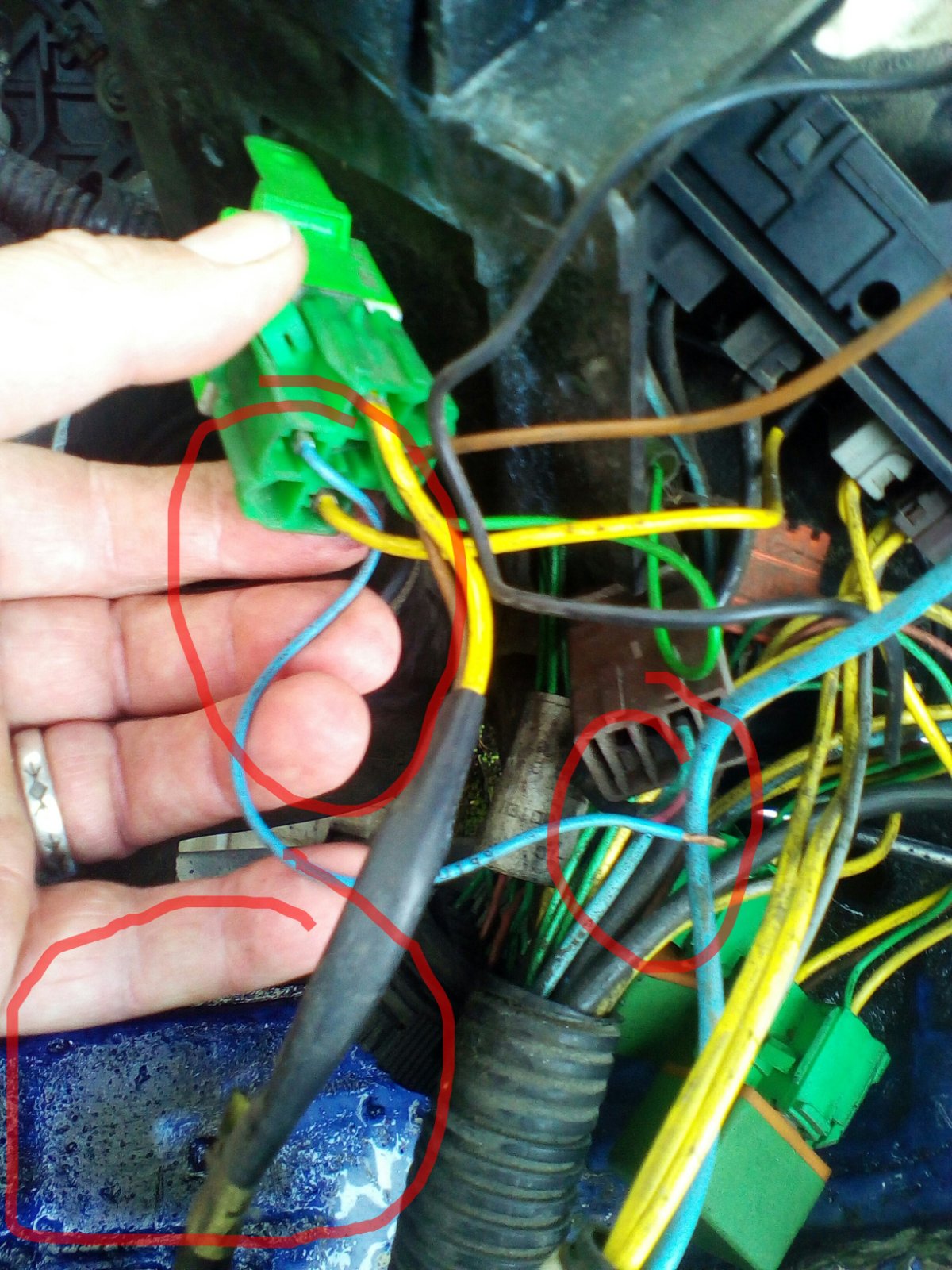

I've had to move the black box which houses the relays battery side under bonnet.
One relay has a light blue wire which is coming out of The relay and its come disconnected bit I'm not sure where , any one ?

Thank you Richard,
As the photo shows the small blue wire I'm not sure where it came detached from
And the red circle on the body is a plate I welded today
I'm rust proofing the car and what I find neededs plating I do as I go along ,
Moving the relay box and looms I may of detached the blue wire so if anyone has any idea where it goes ...
Thank you all .
Thank you all .

Good news I've found the connection and it goes onto a black wire down , this is the only wire in this loom area that is disconnected too,
Took about 15 mins to eye them up.

As above , I made a new joint with new connectors sorted the mess of wires and refitted all back where they came from, battery reconnected and she started up straight away
