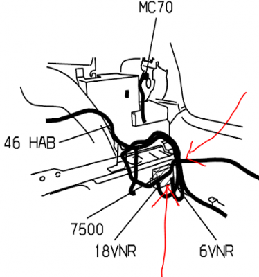

First thing I suggest is having a look at the parking assistance ECU. It's in the boot area - should be on the rear right hand side - I've arrowed in red:
Check to make sure none of the connectors are loose, but more importantly that no liquid has spilled onto / into the unit. Containers of screenwash or water are notorious for leaking and the liquid draining out below and onto these units.

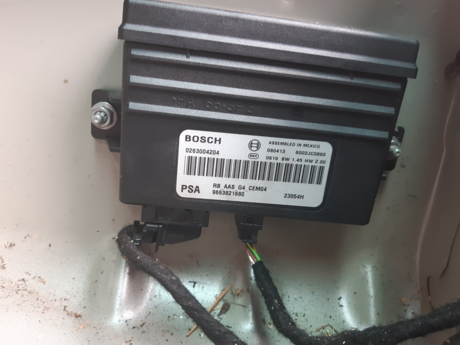

Thanks for the quick reply Marc. Forgot to say that I had checked the ECU . It's on the side of the spare wheel well on the Tourer and was bone dry. Connectors not loose. Just put a chair 1 foot way from the rear of the car and engaged reverse. Momentarily sensed it on display and audibly, but then stopped working whilst still displaying the car outline on screen. I fear the ECU may be on the blink even though Lexia says it's ok. This is wierd

Thanks Marc. Yes the front sensors were a dealer add on.The second hand ECU I found on ebay was only £14 so worth a punt. It is exactly the same part number as the one in my car. Seems like the same part was fitted to a variety of other Citroens including the C4.
Is it plug and play or is Lexia authorisation required?

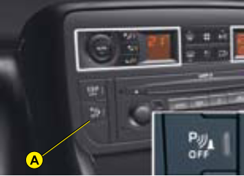

Ok, so I'm having a look at this, but you'll have to forgive me if I ask this.... but are you 100% sure that the parking assistance disable button has not been activated on the dash accidentally?
Secondly, when replacing the ECU, did you follow the BSI Reset / Battery Disconnect / Reconnect Procedure? This is specifically mentioned when replacing it.
petef
- Posts: 193
- Joined: 23 Jul 2006, 20:46
- x 11
Re: C5 x7 rear parking sensors not working but computer says yes
I'll just about forgive you. Yes I'm 110% sure the disable button was not activated - except when I was checking that it worked in parameters on Lexia. If it was turned off nothing would show or be heard when reverse is engaged anyway. I haven't done a BSI reset, doesn't seem necessary, - new ECU was recognised fine and configured and settings saved on Lexia.
