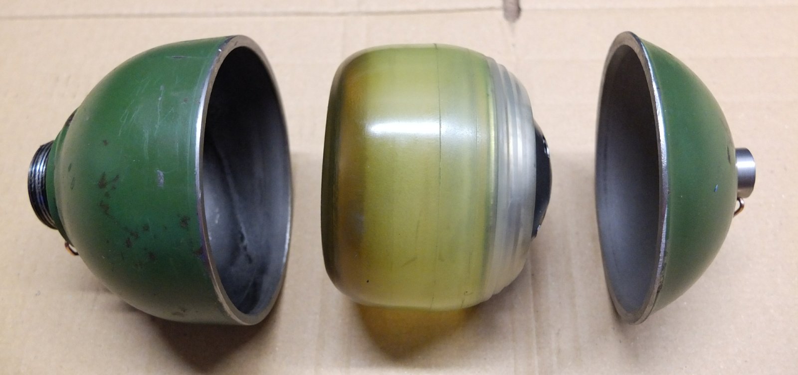

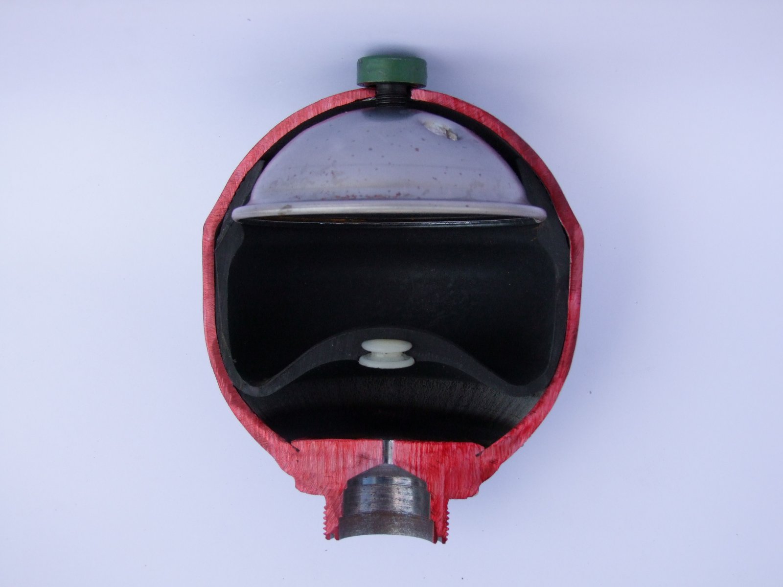

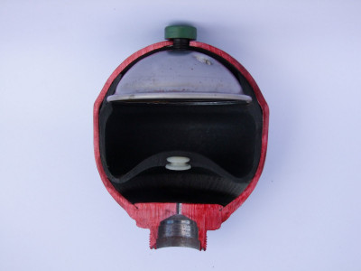

This first picture is of a sphere I replaced because it was down to half its nominal pressure. It was fundamentally healthy, just old.
You can see here just what's inside one of these mysterious green balls.

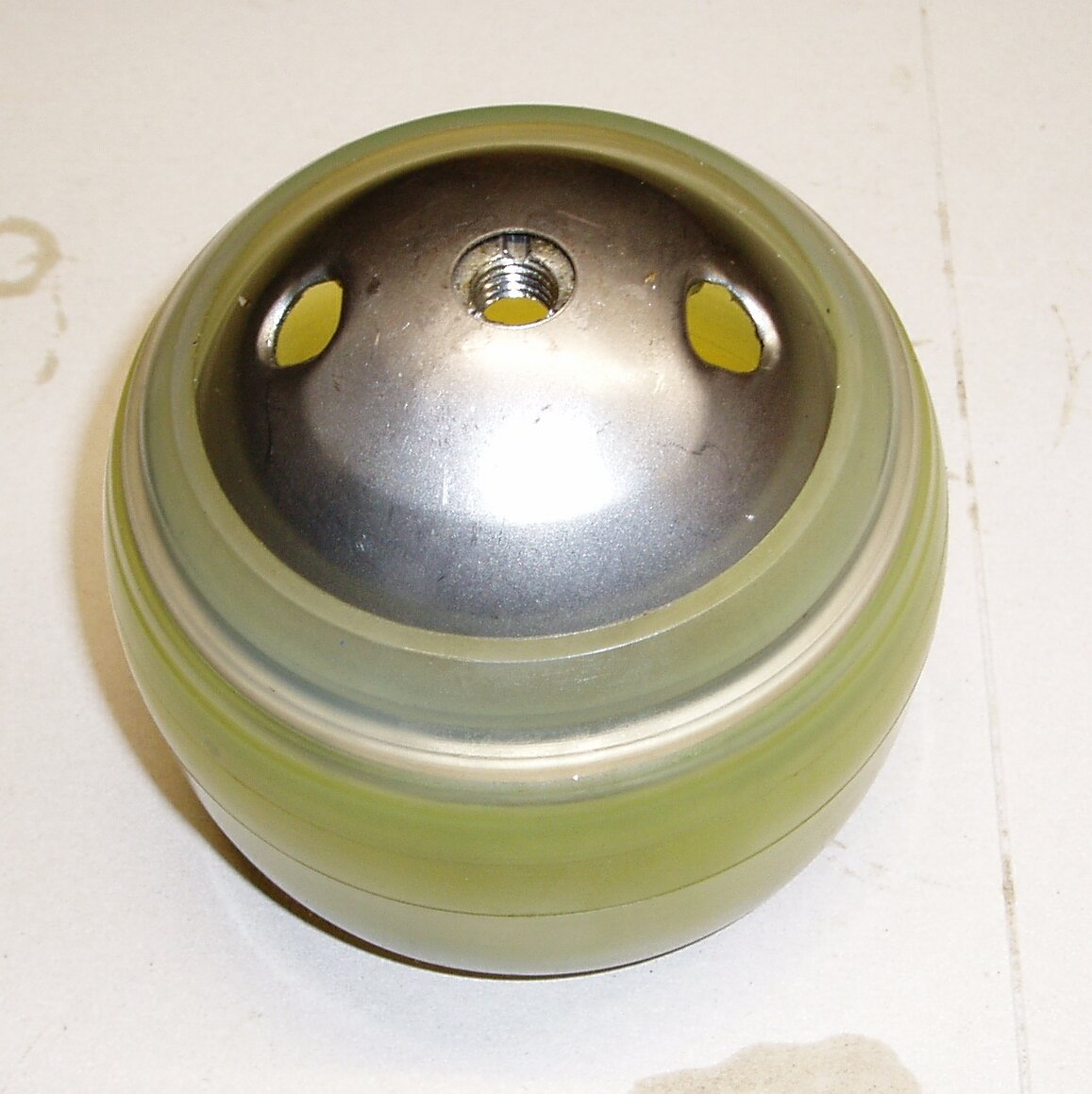

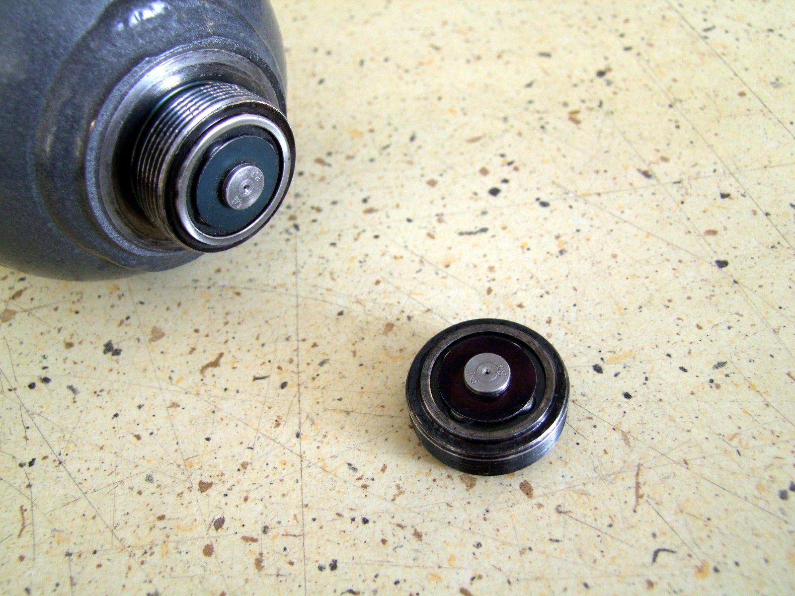

This shows the metal section that closes the membrane.
The idea is that this metal dome is secured by the screw at the top, creating a gast-tight seal between the edge of the membrane and the upper body of the sphere.

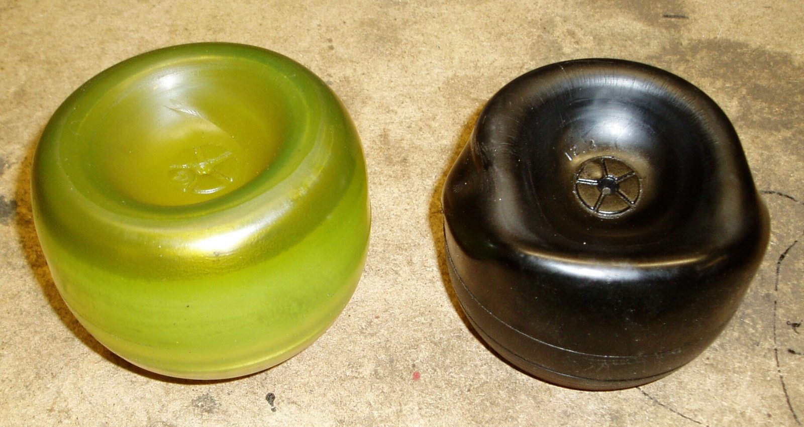

Now we have a comparison between a good membrane and one from an accumulator that was completely dead, probably as a result of heat.
As well as being black, the bad one was also much harder and less flexible than the other.

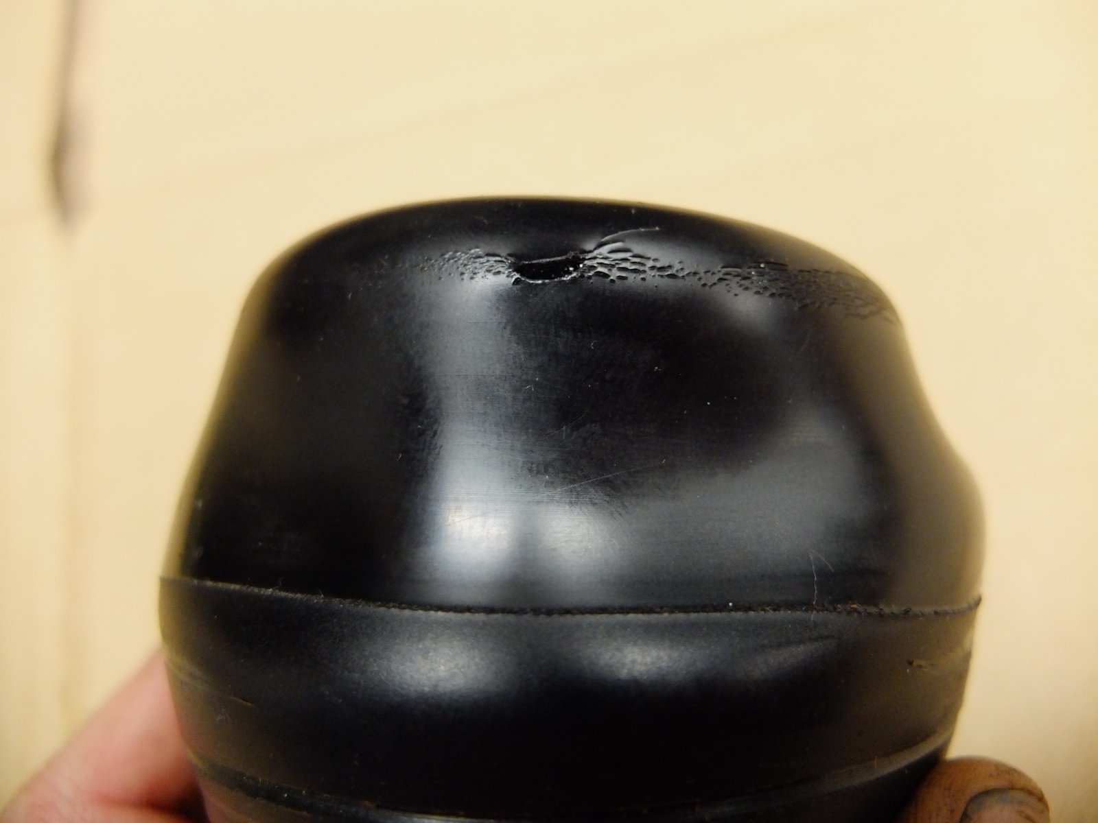

This shows the split in the membrane

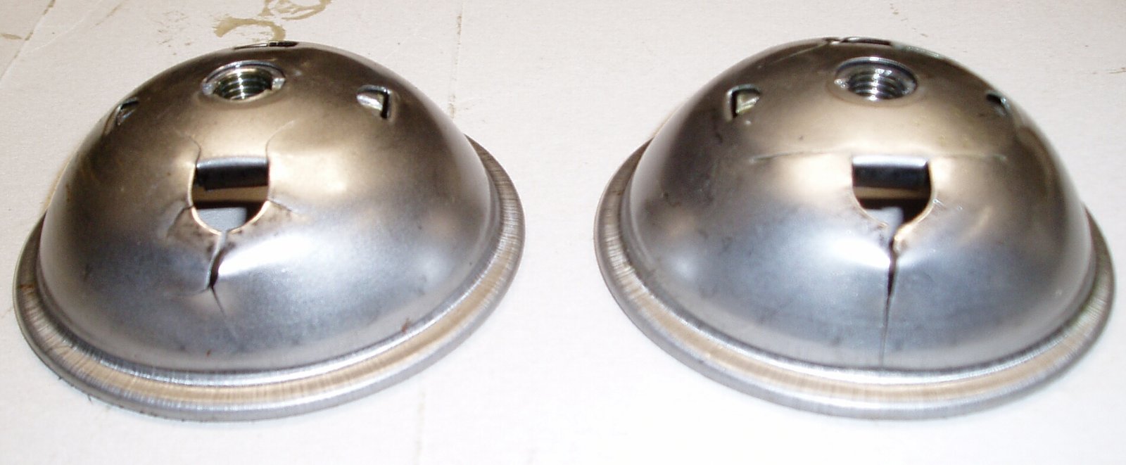

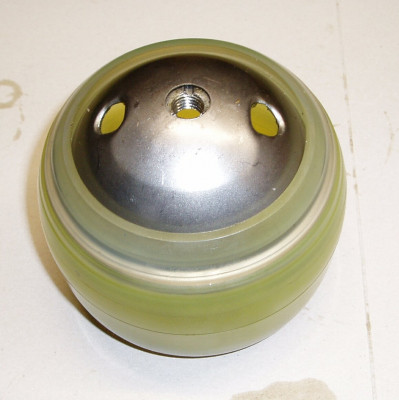

The fault lay in the metal domes, which both showed fatigue-induced cracks, starting at the edges of punched holes. As a result the dome has deformed and the seal between the membrane and the sphere body has failed.

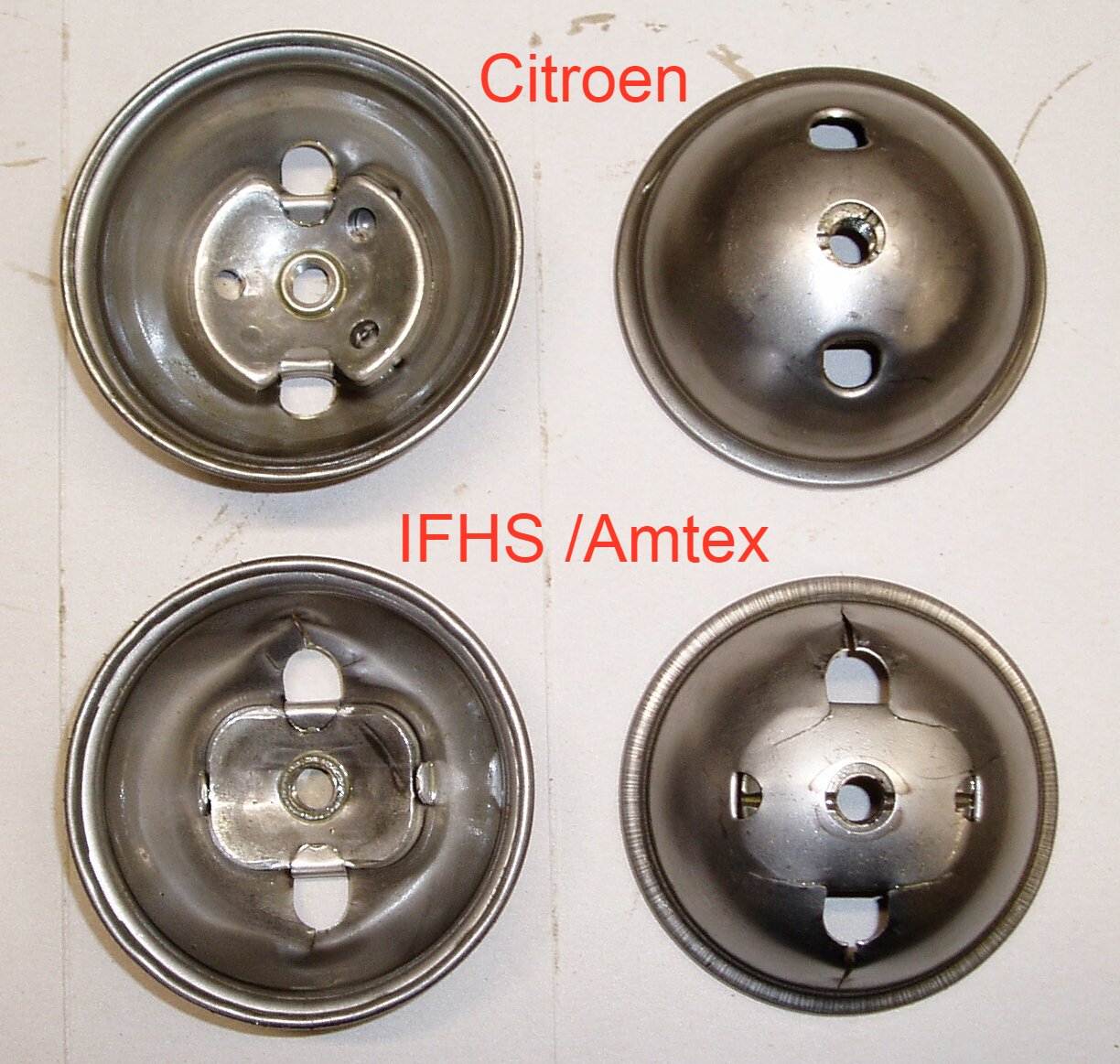

This shows a comparison betweem the domes of aftermarket spheres and what I think are genuine Citroen parts (which have the pressure stamped into the shell, in addition to ink-jet printed part numbers).
A slightly blurred close up shows the cracks a bit better. What's not very clear in the photos is there's distortion around the D shaped holes, and rather than the curve of the D being smooth, it comes to a point in the middle. If you were setting out to design a stress-raiser, it would be had to do a better job. The Citroen parts are significantly better finished.

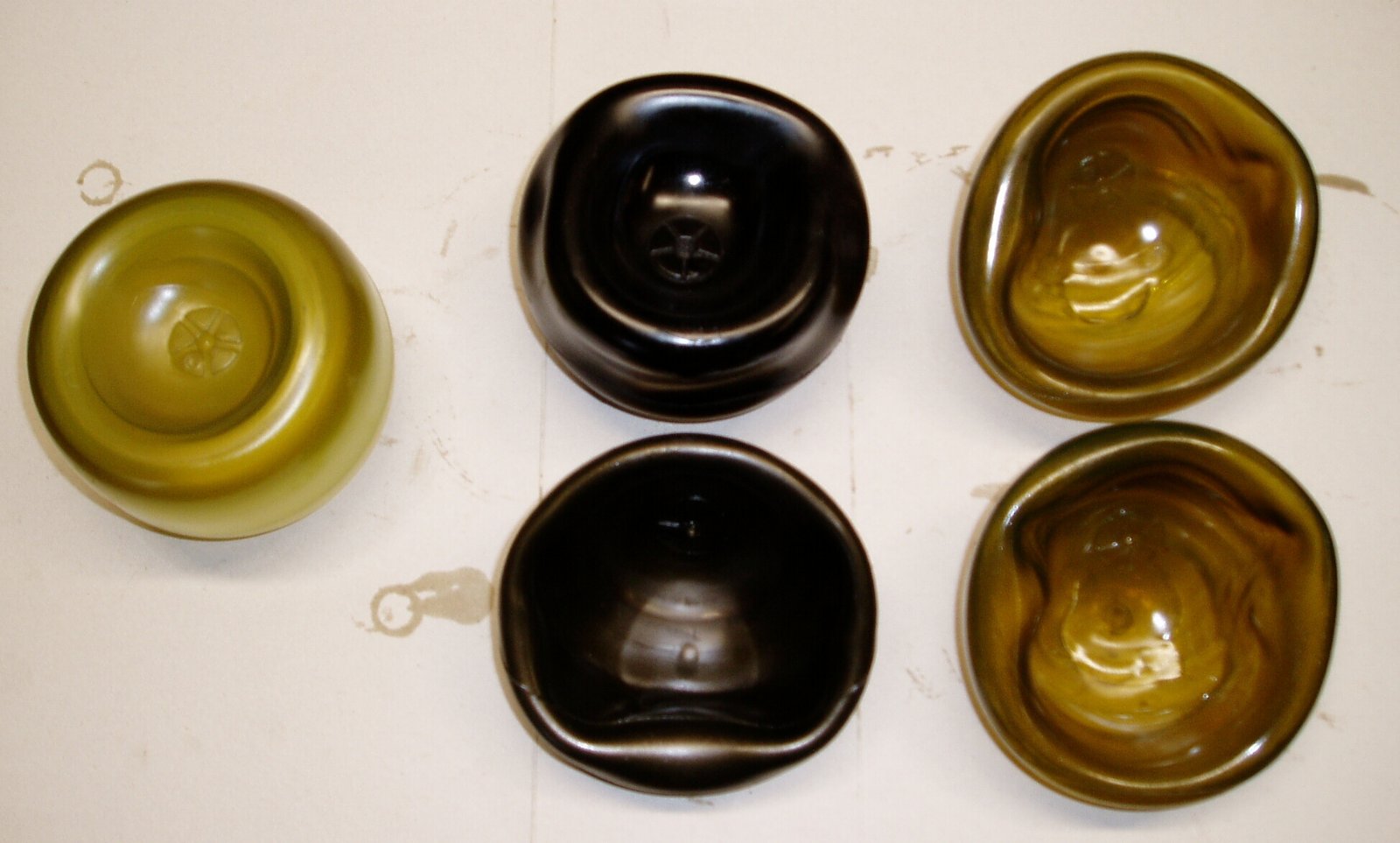

In total, I've cut open 5 spheres; these are the membranes.
On the left is the good one; it was in a sphere that still had 20+ bars of pressure.
In the middle are two from Xantia accumulators, where I think the heat has killed them. Both were quite rigid and hard compared to the first.
The 2 on the right are the ones where the metal domes suffered fatigue cracking. They are still flexible, like the the one on the left, though deformed because they've been compressed against the sphere body when there was no gas to act as a cushion.
Yes, it's been an interesting afternoon.

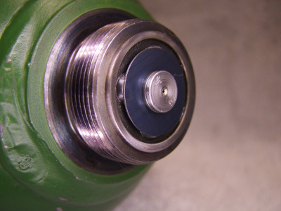

If you want to re-use the sphere, it might not be a good idea to push against the diaphragm with the top bolt removed.
Without the bolt tightly in place, the established seal between the diaphragm and the upper sphere surface will likely be broken, which might not help subsequently.
When I fit Valprex valves to existing spheres, I'm always careful to remove the plug/bolt gently, so as not to push down on the dome plate.
So, mildly interesting ?
People talk a lot about spheres losing pressure over time, but I haven't seen any discussion about fatigue failures before.
Cheers Eb
