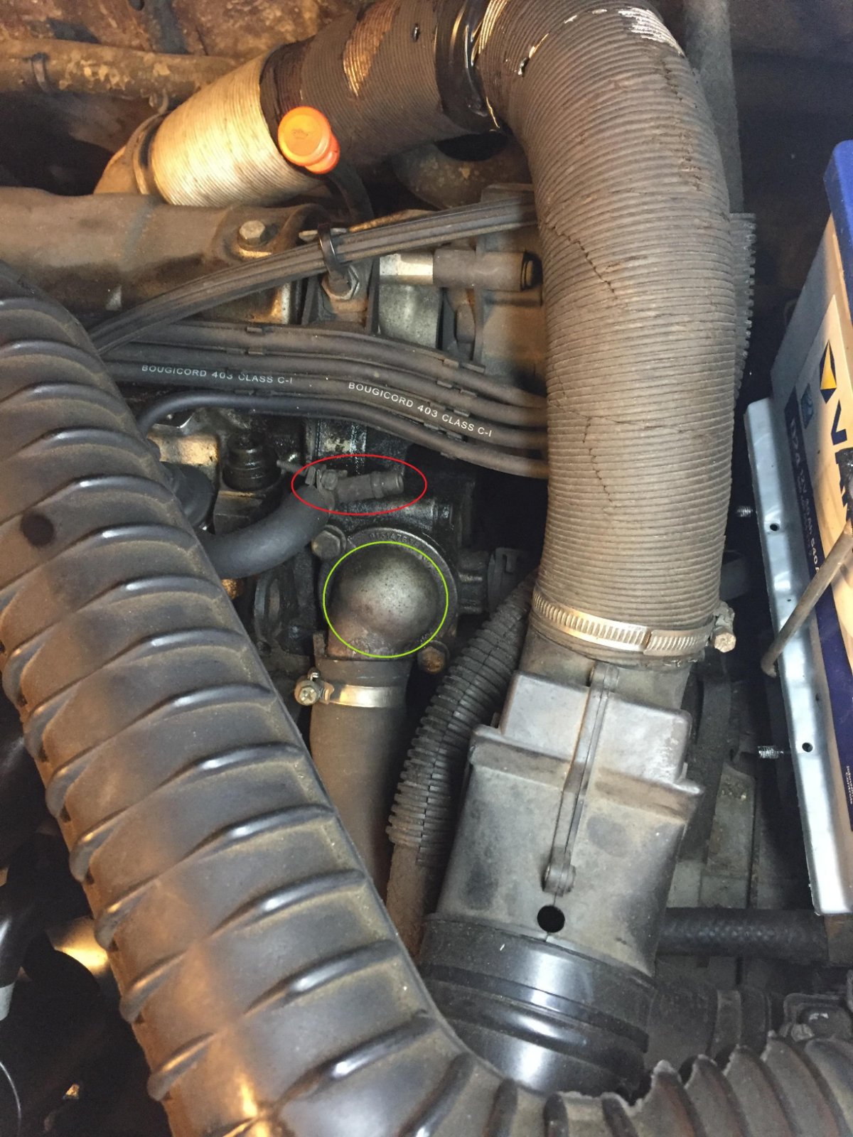

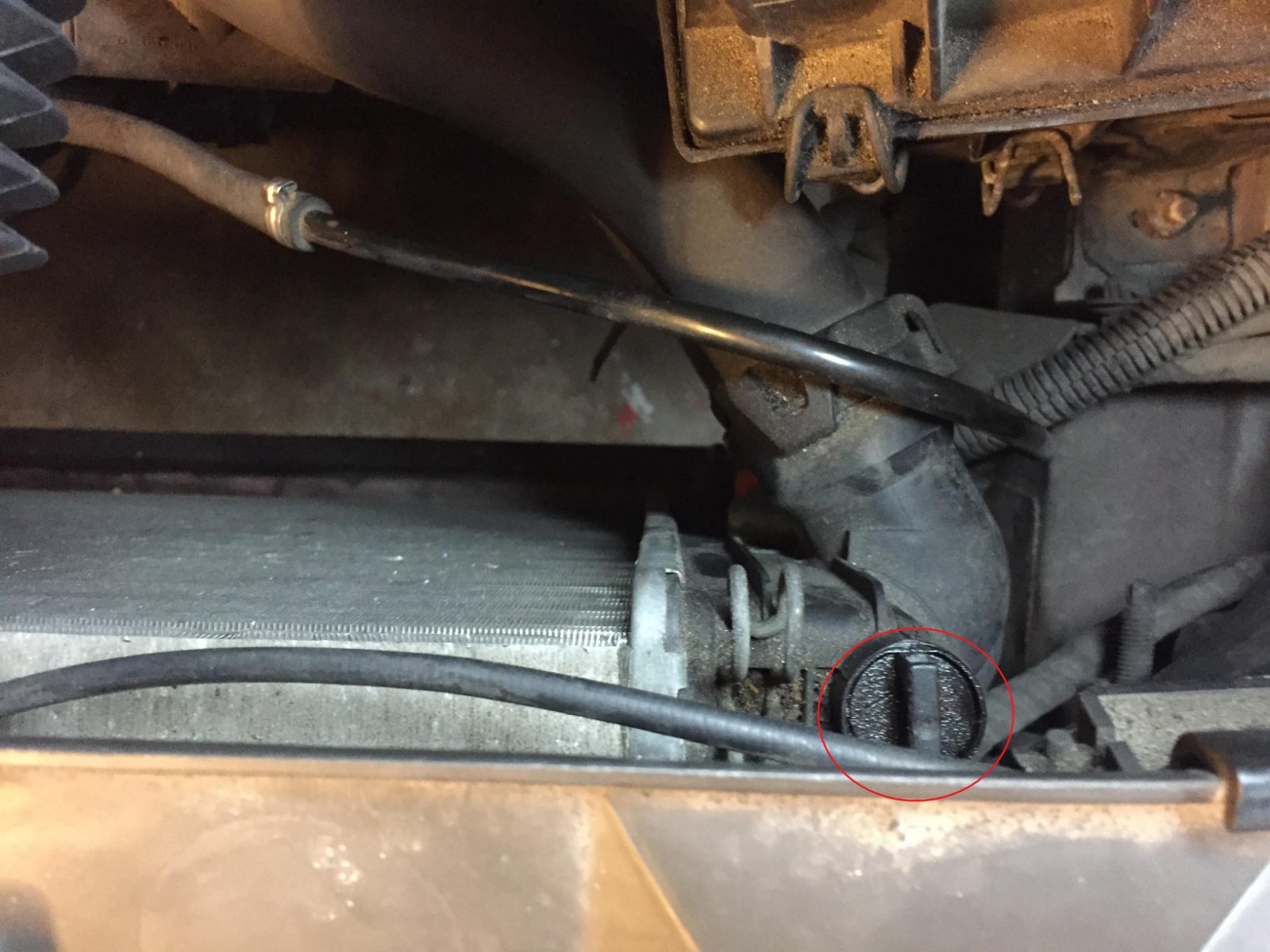

I can only find 2 coolant bleed nipples on my Peugeot 405 1.6i XU5M engine (one on top of the radiator and one near the thermostat both marked in red). Please see attached pichtures. I miss one on the thermostat housing itself (like the Haynes manual shows), marked in green. Am I right? This is strange because everything is original to my engine and I am still the first owner so I know whats repaired in the past.
When I order a new thermostat housing cap I get one with a extra bleed nipple on it. Is this a upgraded part from Peugeot?

Your photos show a perfectly normal set up, no need to change it. I think a bleed valve in the stat cap is for the radiators without a bleed valve. Think about it, stat cap or rad top, they are at either end of the top hose so both do the same job.
By the way, I think you will also find a bleed valve on the heater hose near the bulk head.

Thank you for your replay. I agree with you that both bleed nipples (on top of the radiator and on the thermostat cap) will do the same job. But when I look in Haynes I see this bleed nipple in the drawings. I can not find a bleed nipple on the heater hose near the bulk head (to the heather matrix). Just 2 pipes.
One more question: there is no bleed nipple just before the thermostat, how can you then bleed the system corectly? I mean when you fill up the system air gets traped before the closed thermostat and the thermostat has to open to let the trapped air out to the radiator. But when there is air around the thermostat instead of coolant it will not open, or am I wrong?
