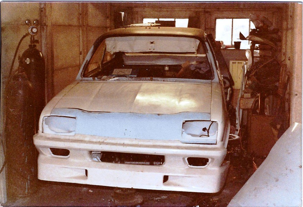

My Chevette was built using two (!) hatchback bodyshells and a new roof panel (I still have a spare unused roof panel in my lock-up). I decided to make the bodyshell into a group 4 type but retained standard wheel arches as I didn't intend to use a 2300cc engine (but I'll come back to that another time).
I used panels from a chap called Ian Jemison for five-link rear suspension and larger propshaft tunnel. I also bought an adjustable pedal box and then bashed the bulkhead around until it fitted (you were supposed to cut it out and weld new bits of sheet steel in). I replaced the tailgate and bonnet with glass fibre items and fitted perspex windows in the tailgate and rear sides. For safety I retained the standard glass in the doors and a new laminated windscreen. At the front I fitted an HS airdam but modified similar to the Gp 4 fronts so that the bottom lip could be replaced separately. As far as I am aware I was the only person to have this modification to the standard airdam.
My intention was to make the bodyshell as near to a Gp 4 as possible but narrower. I bought a back axle off a Mk II Jaguar and then shaved the brackets off with the intention of welding suitable five-link brackets on but then realised it would be too wide of course! So I obtained an English Ford narrow back axle (possibly off a MkI Cortina) and fitted the five link the brackets on that. Unfortunately I didn't get the position quite right (the diff nose pointed towards the floor too much) so I had to reposition the top link mounting holes further along the bodyshell to retain the parallel position and length compared to the bottom links.
At the front I took the subframe and strengthened it. I also welded the bottom part of GpIV engine mounts there. I took a deep breath and bought quick rack internals from Blydenstein's and then had to buy an Opel Kadett type rack to put it in as the British rack wasn't compatible. I converted the bottom suspension arm to rod end bearings and on the upper arm converted to the larger HS type of ball joint. I started off with the standard anti-roll bar but that was too stiff and then made a thinner one (9/16" IIRC) later on.
I wanted Ford centres so that wheels would be easier to find and after spending hours studying bearing books discovered that the Mk1 3l Capri used the same size. The disc offset was slightly out but fortunately after machining the rust off they just fitted inside the calipers. The calipers were new Girling M16 types (Girling had a factory in nearby Bromborough at the time). The 3l Capri also supplied the rear brakes which were essentially four stud versions of the five stud brakes fitted to the MGC so I had a good source for further spares.

A couple of photos from waaaaay back when the bodyshell was under construction. The bear in the first photo is the author in his prime.
