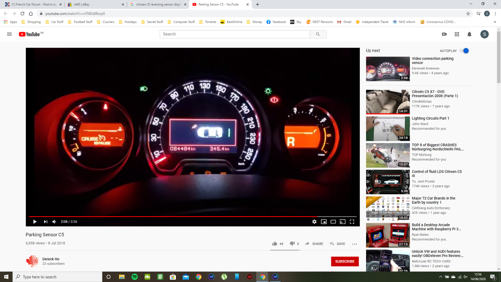

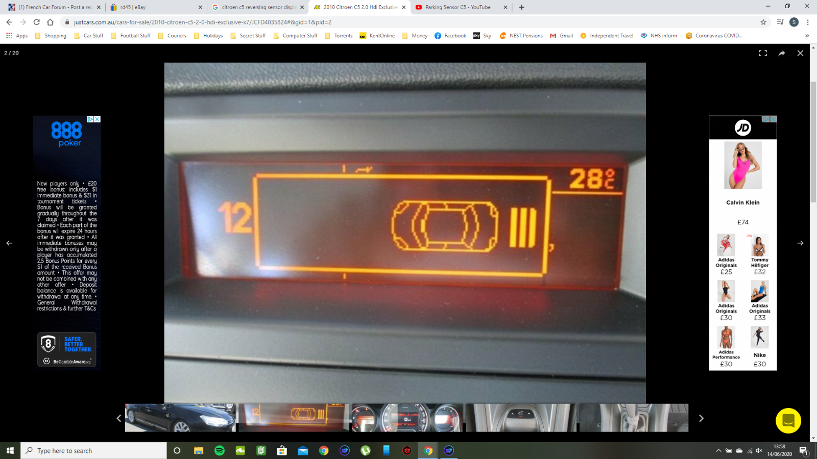

2, I have replaced the orange display on the dashboard, as mine was just black. I purchased a used display from ebay, which was supposed to be from a 2010 C5, But now when I reverse I haven't got the car shape showing the distance increments, Is a 2010 display no good for my 2008, or have I turned off the reversing feature ?

I think from 2010 the rear parking display was moved to the instrument cluster, So I need a setup from 2008-2010 for my parking sensor display , Doe's that sound right ? The replacement screen I purchased was from a 2010, So I don't think its compatible with my earlier rear sensors ?

2) No, the parking display was never moved to the central instrument LCD display. It is always displayed on either the small or the full colur screens on the central multifunction display on the dashboard. The idiot in the video has configured his C5 X7 for the X7s that are made in China. These for all intents and purposes are different vehicles. Doing this may adversely affect the other systems or warnings.
So to answer the other part of your second point, year has nothing to do with the screen type - it is all down to the options specified / available at the time the car was produced.

Your new screen has come from a car without rear parking sensors and this will need to be activated with Diagbox software as originally stated.

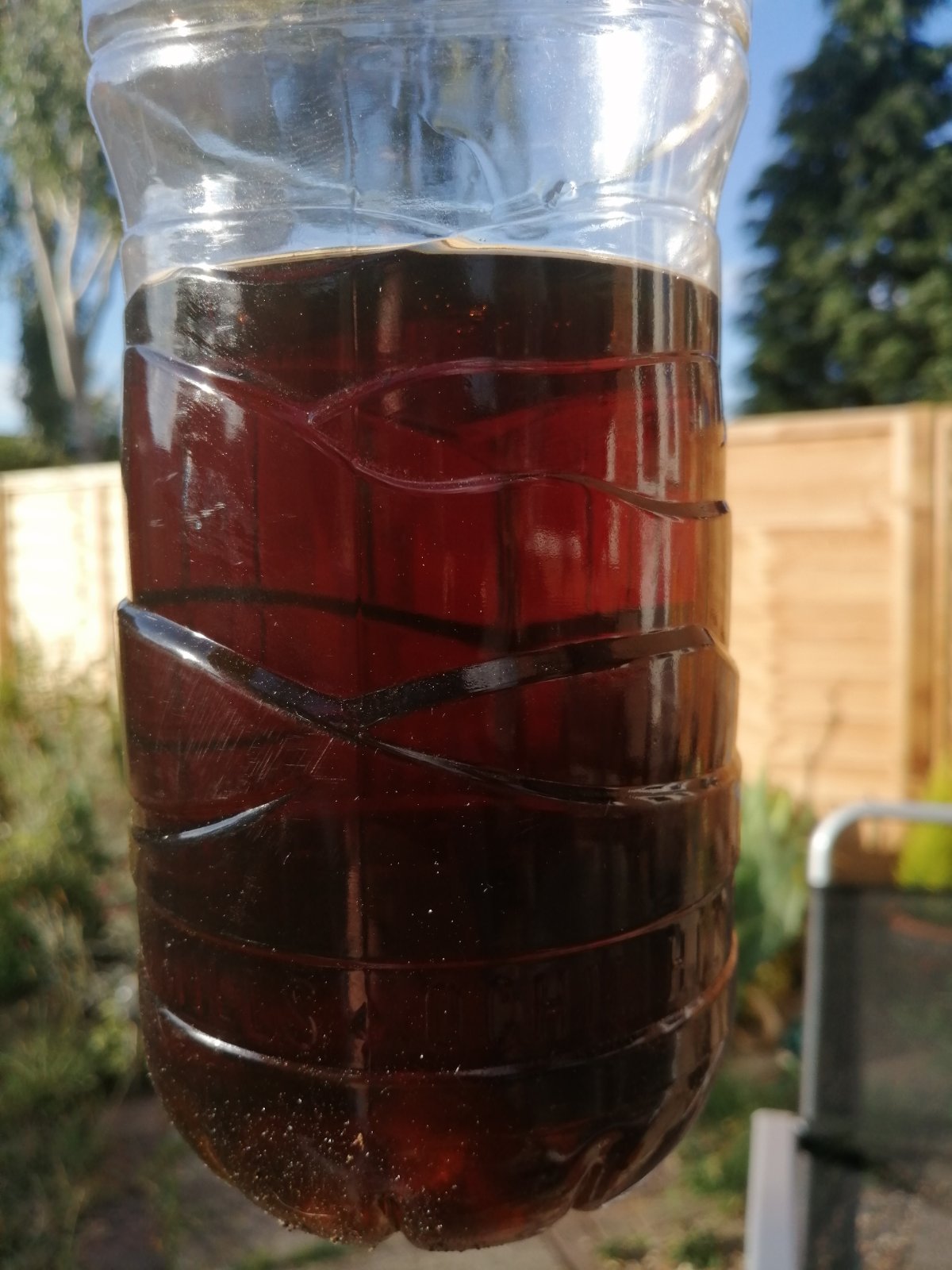

Thank you all for your replies, I have bled the steering and it is much improved, but is still a bit knotchy near to fulll lock, the system was a little over filled, should the fluid look this colour or is it due a change. How would I go about draining this fluid if it is deemed old? Thank you for any help.

LDS / Fluide DA is a brown / orange colour and should not need changing regularly.
