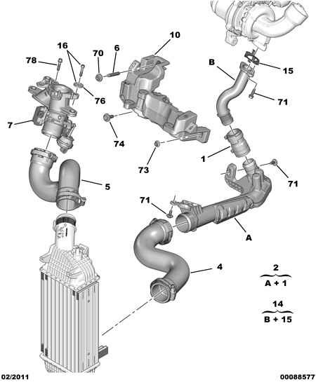

Looking at the the parts diagram for Bela's DW10, I presume it is the cold air mixer since the piping runs from the turbo to the air cooler and into the air doser
Could this be sticking causing her engine to rev between 1500 -1800 rpm.
