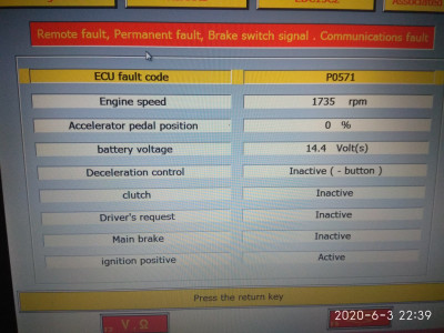

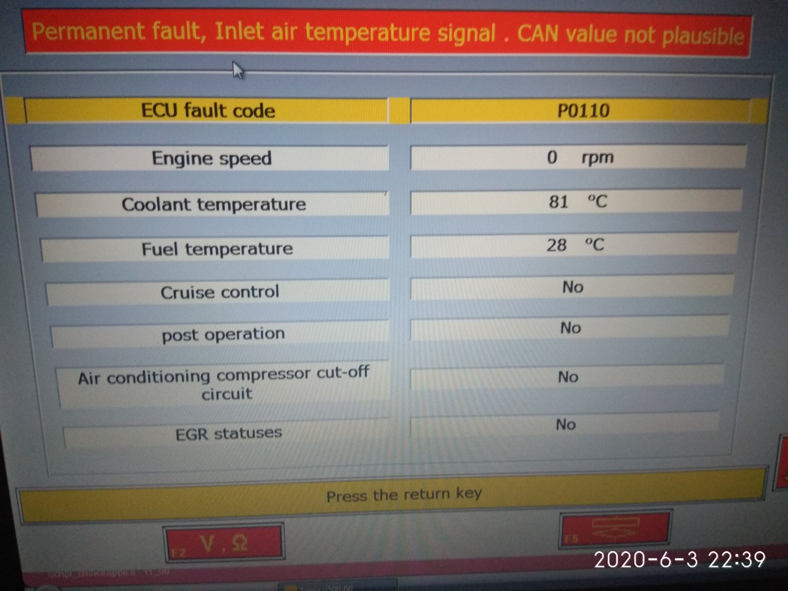

Anyhow, images attached. Can anyone inform me what this could be related to?

dave_xsara wrote: 03 Jun 2020, 23:19
What I noticed when running the global test e that when the bsi was completing, the fuel gauge would drop to empty and the low level warning would come on and remain on until power was cycled. If this normal.
Its totally normal for stuff like that to happen during a diagnostic communication, you usually also get ABS & airbag system faults flashing up when its talking to the respective system.
Ignore the evaporator temp sensor, speed info fault & the brake signal fault. They are known 'phantom' faults & will be in nearly every RHY/RHZ engine you scan.
Although before ignoring the brake switch fault just confirm the brake lights are working correctly.
If you had a charging issue I reckon there would almost certainly have been other electrical symptoms, I'd say the fault you experienced would almost certainly be caused by P0190. First off how old is the fuel filter? is this a Bosch or Siemens system?
EDIT: Just checked & it turns out the alternator fault code is also a phantom fault.

wheeler wrote: 05 Jun 2020, 13:22 Ignore the evaporator temp sensor, speed info fault & the brake signal fault. They are known 'phantom' faults & will be in nearly every RHY/RHZ engine you scan.
Why is it when you go into the live data, are the clutch and accelerator presses detected, but the brake switch is not?
I checked and the brake lights work correctly.

There may be more than one brake switch in live data, sometimes a second one for cruise control if fitted. Failing that it may just be a software glitch.

P0110 (minor fault)
Air Temp sensor built into MAF if you have the VDO/Siemens unit
Between Pins 1 - 3, you should see between 2500-5000 Ohms between 20 degrees C air temperature and 5 degrees air temperature (ie current weather conditions)
