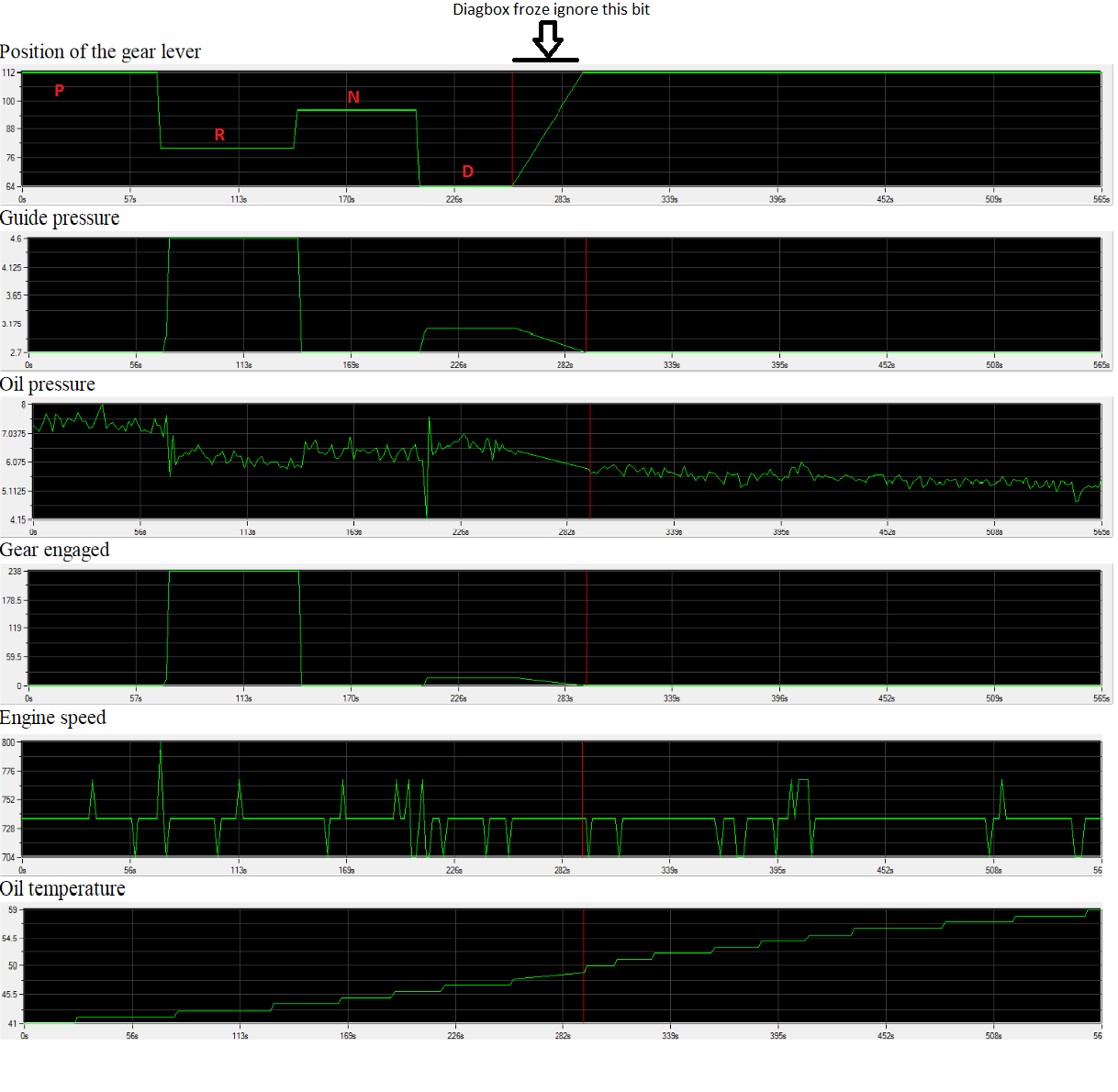

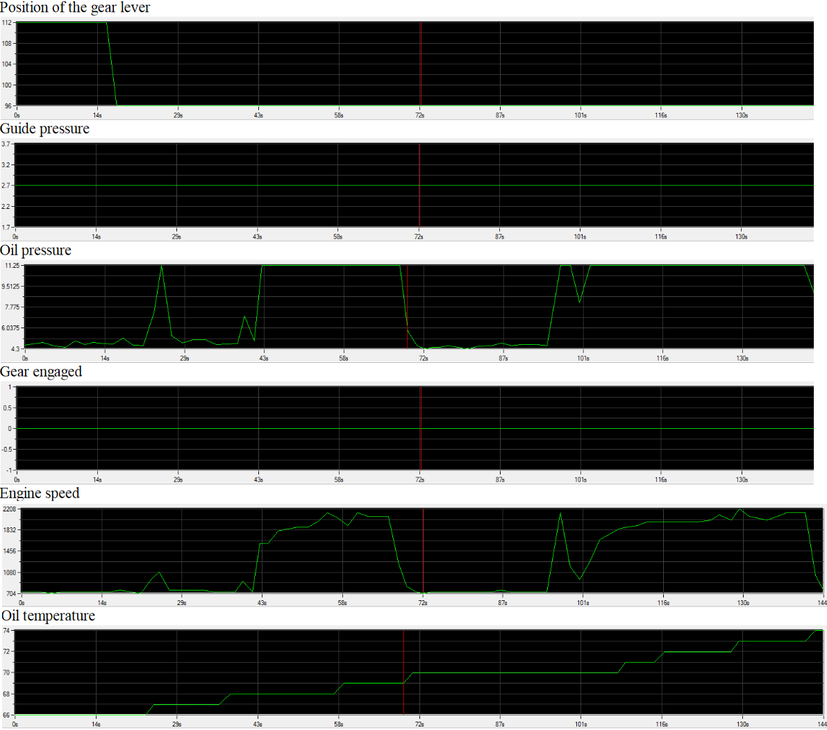

I monitored variables through Diagbox and this is what I found (see graphs below):
  • Oil pressure starts from 11.2 bars and the gradually falls as the oil heats up
  • Pressure almost doesn't change when putting into different gears
  • Whenever there is any load on engine pressure instantly goes to 11.2bars regardless of a gear
Oil pressure under load
Because of this as soon as I try to drive gearbox goes straight into limp mode with error P1167 Pressure regulation fault (difference / reference value)

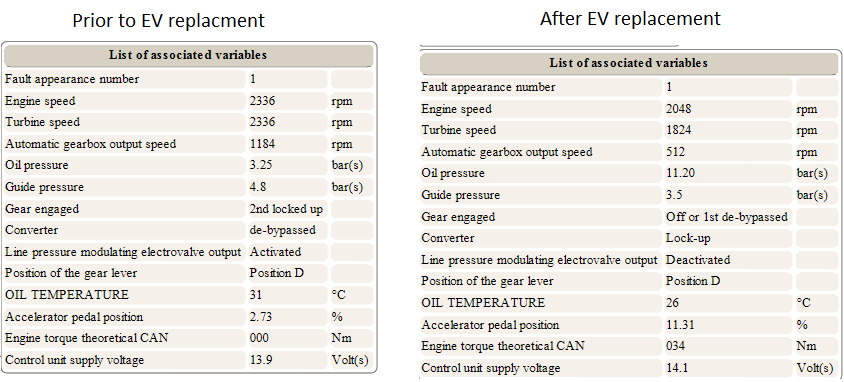

Another thing is that I noticed that on old fault reads main pressure regulation valve status says activated whereas now is deactivated. Does it mean that electrovalve is broken?
Faults before and after EV replacement
Both old and new EVs were of the Borg Warner type. It's 2006 C4 mk I 1.6.

I attach more graphs that capture oil pressure over time as the oil temperature increases.
  • Cold oil
Spoiler: show
Cold oil
Cold oil
  • Warming up, circa 35 degrees
Spoiler: show
  • Reaching operating temperature
  • Warmed up
Spoiler: show
Warmed up
Warmed up
