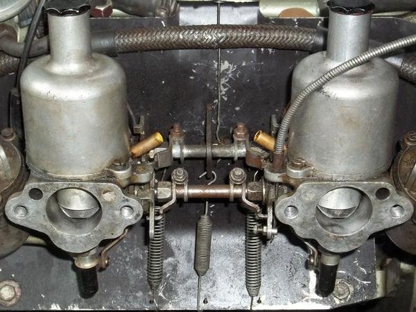

From memory, there were two main adjustments needed for twin SU's: air-flow and mixture, and a small one for throttle synchronisation.
Setting mixture was the same as for a single carb. With engine warmed up and at idle (and the dashpot properly filled - not engine oil, please, Haynes!), the piston needed lifting by about 1mm, using the little lifting pin in the carb base. You listened to what happened to engine revs. If the revs rose, and stayed there, the mixture was too rich. If revs fell when the piston was lifted, the mixture was too weak. The mixture was correct when revs rose for 2-3 secs, then fell back again. The mixture was easily adjusted with the large jet nut at the base: screw out to enrich, in to weaken. Simples, infallible. For twin or more carbs, you just did this for each.
For air-flow, the aim was to get the flow of air through each carb equal. This could be done with a simple length of plastic tubing, used as a stethoscope. With one end near your ear, the other end was positioned (engine idling) against the intake flange of one of the carbs, and you listened to the hiss. This was then transferred to the other carb, in the same position, and the hiss compared. The louder the hiss, the greater the air-flow, and the aim was to get both of them the same. This was done by adjusting the idle speed screws on the carbs, which set the opening of the butterflies at idle. This was done while keeping an eye on correct idling speed.
More accurate than listening to airflow, was monitoring it with a carb balancer, which allowed air-flow to be read off visually on a scale. The Gunson's Carbalancer used a plastic venturi scale, which contained a little plastic float that hovered in the air flow. You pressed the unit's shallow cone to one carb intake, and set the shutter on the cone to put the little float roughly half-way up the scale. Transferring the cone to the other (or next) carb allowed the air-flows to be compared. Again, adjustable on the idle screws.
IIRC, it was recommended (on twin carb set-ups) that one throttle butterfly opened minutely before the other, when the throttle was opened above idling. This tiny headstart for one carb was obtained by adjusting the linking shaft between the two carbs, and tweaking the gap in a forked link.
____________
Do remember, with some dismay, having to deal with the twin Strombergs on our Dolomite 1850. One of Triumph's specialities was uneven idling, and this wasn't helped by the two Stromberg carbs drooping somewhat on the end of rubber mounts (rather than being solidly bolted to the intake manifold, normal for SU's). A top-side spring attempted to counter gravity, acting on both the carbs and the substantial air cleaner. What an arrangement! Later discovered that lumpy idling was also a characteristic of the monopoint injected TR6, when I tried to tackle it with a friend's purple lovely. The Dolomite was huge fun, but the list of things that Triumph got wrong was pretty lengthy.

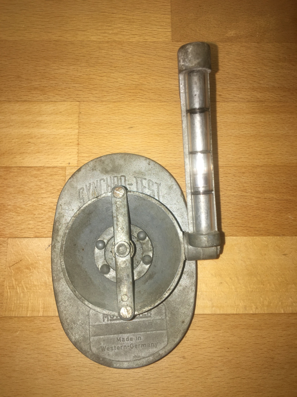

Can’t remember the last time I needed this carb balancer
