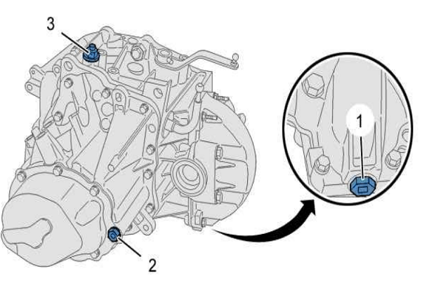

Re: gearbox code ??
also do i fill transmission oil into drain plug or what is correct procedure for filling oil
i took the drain out with car on the flat and nothing came out
UPDATE... i had removed level plug lol
on finding correct plug at bottom still only 50-100mm oil ( no bbs or debris tho) ???
so probably going to add 2000ml 75-80 manual trans oil fully synth see what happens
would a dry box sound similar to a shattered bearing ??

Re: gearbox code ??
Ok, so the breather orifice (3) below can also be used for filling the gearbox.
(1) Drain plug.
(2) Filling and level plug.
(3) Breather.
Quantities:
Gearbox empty: 1.9 litres.
After draining: 1.8 litres.
(1) Drain plug.
(3) Breather.
Quantities:

Re: gearbox code ??
filled box with 1700ml of 75-80 full synth.....noise gone ......car sorted for 30 quid ..unbelievable
thanks man you rule
thanks man you rule
