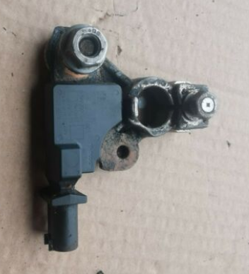

First of all are you saying you removed the Battery Charge Status Unit that looks like this?:
If so, I would suggest you change the BSI configuration to put control of the energy management back to the BSI from the BCSU, or you could end up with a car that won't start. The BCSU undertakes various monitoring functions of the battery's state, including temperature and this information is used to manage the energy saving features of the vehicle. By taking the BCSU off without handing control of this function back over to the BSI which provides a more simplified timed use of accessories you are leaving yourself with open to a flat battery and unable to start the car. See my post here on how to do this:

yes i just disconnected the plug to the BCSU , can these go faulty?

The BCSU paret number was updated, which indicates a replacement part at some point.

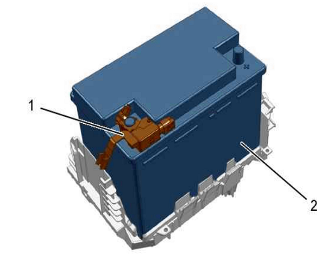

Be aware that the BCSU takes measurements of the battery periodically - so it not an on or off device as such, so I'm not sure that you will be able to determine if it is working correctly or not.C5-NON wrote: 30 May 2020, 17:13 I have plugged the car into diagnostics today, had communication error with the BCSU intermittently so I assume that is faulty. I also did self tests on the speedo,Rev,fuel counters. Rev counter has reset to normal, speedo still sits at 80mph when stationary but does move, the fuel gauge did not move at all under test. Hence I figure I have a mechanical failure of the gauges, and also a faulty BCSU, would you agree?

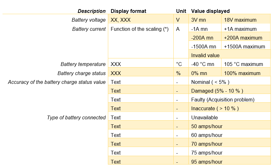

Also, you can use Diagbox to test the BCSU. Just go into parameters and select the appropriate tests, or after the Global test, select the BCSU form the list of ECUs on the list, confirm and this should take you to another menu that will list test parameters and configuration. This is where you would change the battery capacity if it is larger or smaller than the original - but it should not be smaller than the recommended.
Under the parameter tests, you should be able to read things like thge battery voltage, battery current, temperature, charge status, accuracy of the charge status value, and the type of battery connected in terms of Amps/hour etc.
Here are the values: (you will need to click the image to clarify & magnify it)
(*) For the battery current display, it is very important to use the correct current scale when reading the battery current as an incorrect scale does not provide the correct battery current value.

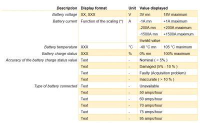

I have purchased a new BCSU and fitted it, car now recognises it, and so far i have not got battery charge warning indication (going on long drive tomorrow though so will test it properly i guess). However when in diagbox, under test - says ECU not recognised after global test, although i actually can read the BSCU now (i can select between two versions however? i assume one is later, but what year car?, i seem to be able to select either and get readings however) .
I have two fault codes
FFF1 Battery charge status unit - voltage sensor fault
FFFE Battery charge status unit - configuration
I found a screen that states i have a 75AH battery, although i have a 80AH fitted, wonder if this could be the reasons for codes? - although i have tried to find the screen to change battery/register, cant seem to find it?
any ideas?
speedo and fuel gauge still not working correctly, although rpm is now after i reset in BSI. - i still think these have failed mechanically ?
