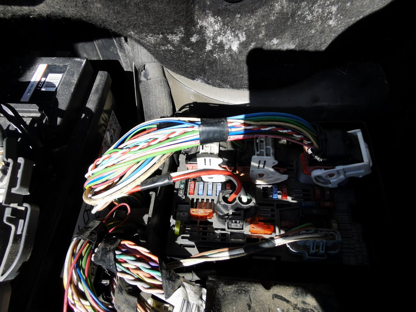

Hello all,
My problem started when I flashed through a bus, since then my high beam will not turn off even when I have taken out the keys. I've tested the comms (Stalks) and everything works and goes through the motions on is on and registers on the dashboard as well as what I'm doing. Now that leads me to the next point of the problem could be the BSM-R05-00 9675878480 which is the part in the motor. I have found that exact parts and number on eBay and ask the seller whether he knew if it would need recoding or would it just plug and play? Now he's responded that yes it should just plug and play if it's the really same number which is? Is this true I'm really am stuck haven't got buckets of money to throw at this.
Or should I find somewhere to repair the one I already have? Any help would be much appreciated

The Engine Fuse Box (BSM / Body Systems Module) does not need coding (ensure you replace with the correct part though). If 9675878480 was the part on your existing engine fuse box then replace it with the identical part number.
